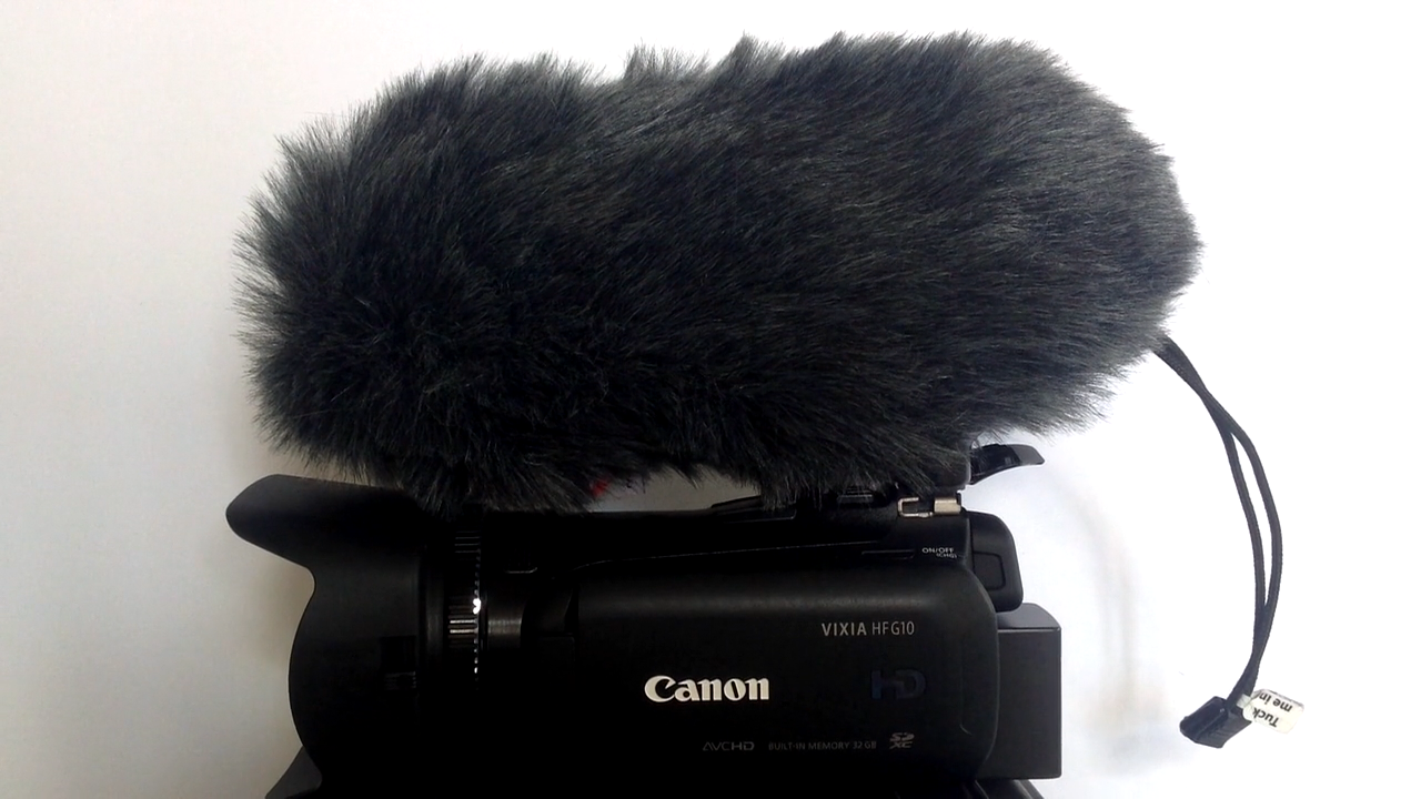

Incidentally, this the prototype custom Rycote Windjammer for the DM-100 that I mentioned - mounted on an HF-G10 there. It's a monster

Yea, that windscreen is indeed large! The Azden appears to be about the same size. But since it would sit a bit higher up as well, it may not be an issue. Thanks for the tip though on mounting to the rear shoe via an adapter. I did manage to find a brand that carries the all-metal mount version and I'd definitely go with that if needed.
