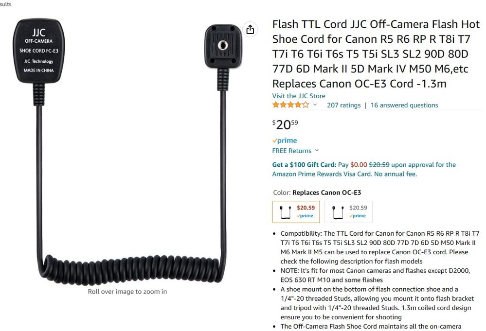

jrhoffman75
Can't link but OK to post an information screenshot. Something like this:
John Hoffman
Conway, NH
Thank you for the idea! They seem quiet short though 😔
The cord solution is the least expensive, but yes, the flash will be close to your camera.
If you need to have flashes at larger distances, you'll need either an optical or radio solution.   With your current 430 EX II, you'd need an optical (line of sight) solution.  So a second flash serving as an optical master would need to be on your camera.   Your flash could then be used off-camera as long as it can "see" your optical master.
You can have the most flexibility in going with a radio solution.   You no longer need line-of-sight as with optical so can place flashes almost anywhere in relation to your camera.  Here, you can either have a speedlight or radio transmitter on your camera.  Then, a flash that can be controlled via radio (e.g. 430 EX III RT, 600 EX RT, EL-5, etc.)

Vello makes one that is 33 feet long. What distance are you trying to achieve?

The speedlite may fire an AF Assist Beam if the camera can't lock focus. When its on the off shoe cord. The camera believes the speedlite is mounted on the camera and not on an off shoe cord. So this will need to be put into consideration if the OP using the speedlite in low light or low contrast situations.

yes i want to do portraits in a parking lot at night
mainly portraits!
