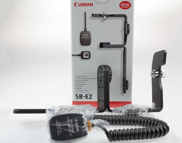

What thread size is the mounting bracket socket on the 600EX-RT?  The manual shows the SB-E2 bracket but apparently it is not available.

You can sometimes get bracket via eBay. It comes with off-camera cable. It's pricey.

The SB-E2 is available on Ebay. The price may seem high but it includes an OC-E3 cord.
