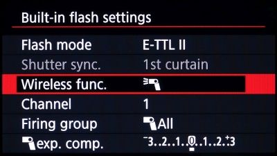

Yes, you can use the 80D built in flash to fire one or both of your external flashed using optical wireless.
Under the Built in Flash settings, select Wireless func. and then select the middle icon for external flash only. The top selection is for flash ratios between the built in flash and external flash and the bottom one is for firing both the built in and external flash together. (You can also use ratios between multiple external flashes)
You will still see the built in flash fire, but it is only sending the coded optical wireless flash instructions and will contribute little or no light to the scene. (if you have a very close subject or high ISO you may see a little light from the built in flash in the photo)

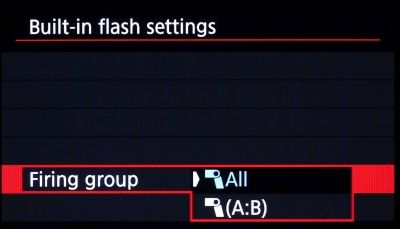

Is the 270EX working as a Slave? Do you have the built-in flash set like this?
