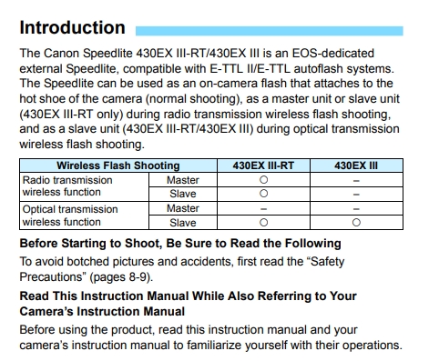

The 430EX III-RT and 270EX II are not compatible in Radio wireless operations.
The 430EX III-RT has both radio wireless capability and optical wireless capability as a "Slave Flash", but only radio wireless capability as a "Master Flash".
The 270EX II has only optical wireless capability as a "Slave Flash", just as the 430EX II in the chart shown in the manual.
You can use your 80D built in flash as an Optical master for both flashes in optical slave mode.
