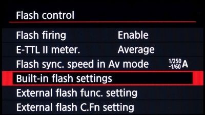

@nav16 wrote:
So I have set my camera to what Mike said. My camera is on Av and the flash on my camera is off. I just want the external flash to go off. With these setting, my 4300 won't go off
Is the 270EX working as a Slave?  Do you have the built-in flash set like this?
