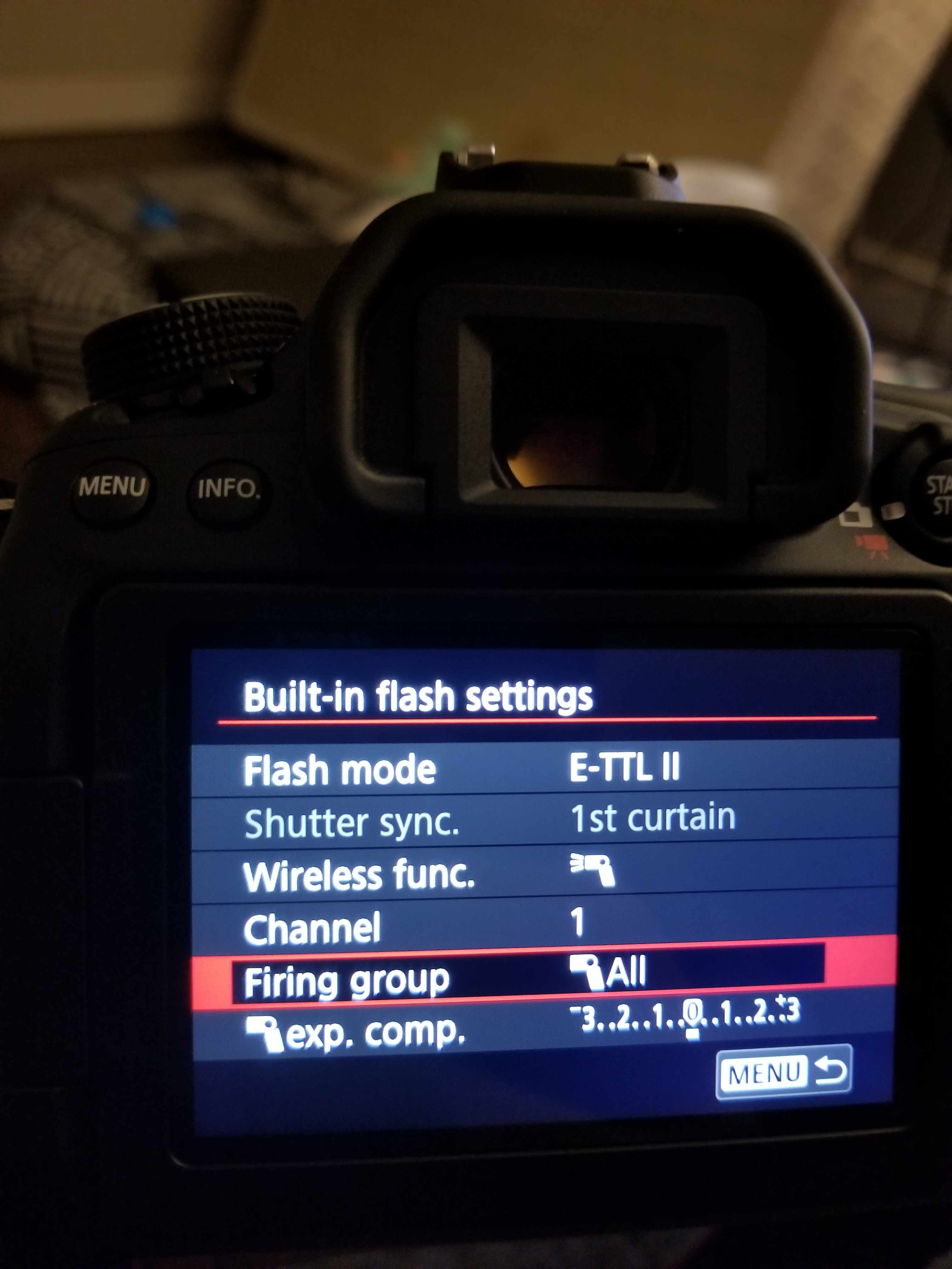

These are the settings I have on my camera and the flash. Maybe it might help out ? Am I doing something wrong??
02-04-2019 09:29 PM - edited 02-04-2019 09:48 PM
It looks like you have OPTICAL wireless enabled. It should work.
Just double check the channel and group to make sure it is all the same.

Yes, the camera's built-in flash must fire to trigger the slave in optical mode.
BUT.... The way you have it set, you will see the flash fire, but it is actually sending coded optical light signals just before the slave flash fires, and you should not see the light from the built-in flash in your photo.
