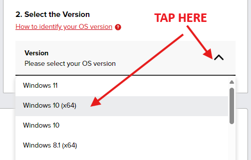

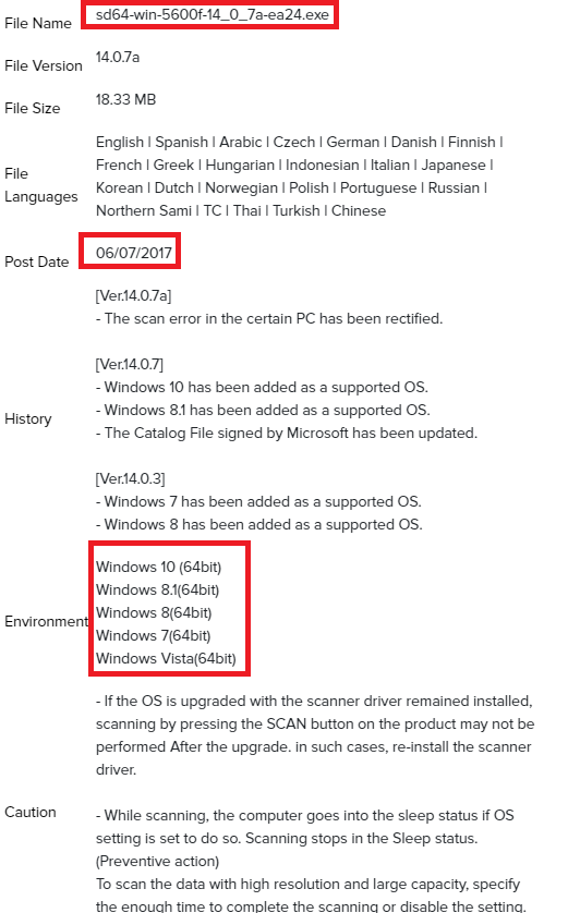

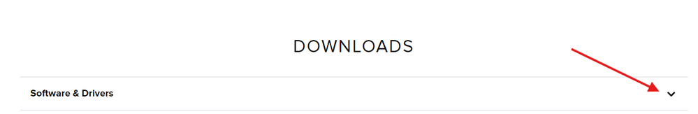

Your printer has been retired and is no longer eligible for support from Canon USA. No further software or drivers will be developed; however, a 64-bit Windows 10 driver is currently available.
Tap this link to go to the support page for your printer: https://canon.us/4gFISKV
Expand the Software & Drivers section, then select Windows 10 (x64)
You'll see this driver is supported by 64-bit versions of Windows Vista, 7, 8, and 10:
