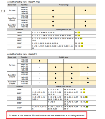

I'll add that that 120fps is possible under S&F in 4K modes under certain system framerates. Audio is not recorded in the clip, and you can record audio separately 🙂
Due to the complexities, I recommend reviewing the video manual for all supported 120fps modes.
eosr5c-aug5-video-en.pdf (c-wss.com)

Hence, all the cameras I know of fake it. They can record 120 -- the R5C certainly can -- but the video has to be tagged as something else, like 24 FPS. Of course this is a bodge, and of course the camera companies don't tell you that, they sell it as a feature. Canon calls this "Slow and Fast", Sony calls it "Slow and Quick".
But the bottom line is that it doesn't matter what the video file is tagged at. It still contains video frames captured at a rate of 120 per second. So, let's say you use "Slow and Fast", recording at 120, but with the output video tagged as 24. In your editor, create a timeline at 120 FPS, drop your video in there, and speed it up 5 times. This cancels out the bodge, and you will have genuine 120FPS video. This will work for the R5C, and should be the same for Sony.
As others have noted, you don't get Audio in Slow and Fast mode. But the R5C can certainly do 120 -- I just tested it on a dripping tap, and it looks great. https://drive.google.com/file/d/1q4vCmK7Iz5jvtU2-x4GTyGfVmk65R-W6/view?usp=drive_link

But for the record, the R5C can record 4k, 120 FPS, XF-AVC, in both All-I and Long GOP (which is IPB) formats. There's no such thing as IPB-Light on the R5C, that's from the R5. But 120FPS is only avaliable in Slow&Fast, and that means no audio.
