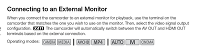

Is the XA11 Camcorder capable of outputting video using both the USB and HDMI simultaneously?
I don't have an appropriate USB cable to test the double output.
Currently, I use the HDMI (mini?) output to a monitor but would like to output the USB to another device.

Doubt this is possible. Let me check....
XA11, switches between outputs based on the connection.
The USB terminal is for GPS.

Greetings asdt,
The Canon XA11 camcorder is unable to output a live video feed from its USB terminal. The USB terminal is for connecting the camcorder to a computer for downloading recorded videos and to a GPS receiver.
