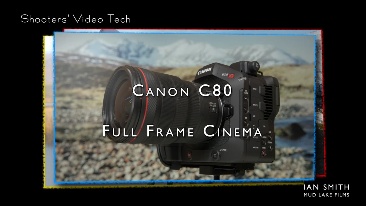

Sadly, all I can say is that I also had no luck using a wired controller.  You can see my review of the C80, where I discuss this at 14:27: https://vimeo.com/1052645939?fl=pl&fe=vl
The good news is that you can use browser remote.  It's a bit of a faff to set up, but it runs on any device with a web browser -- like, but not necessarily, your phone -- and it doesn't need you to install an add-on app.  And of course it's wireless, and you get a live view as well as full control over start/stop, settings, etc.  Clamping your phone to your tripod should be easy enough; I use my phone on a tripod, with a cheapo phone clamp, as you can see in that video.

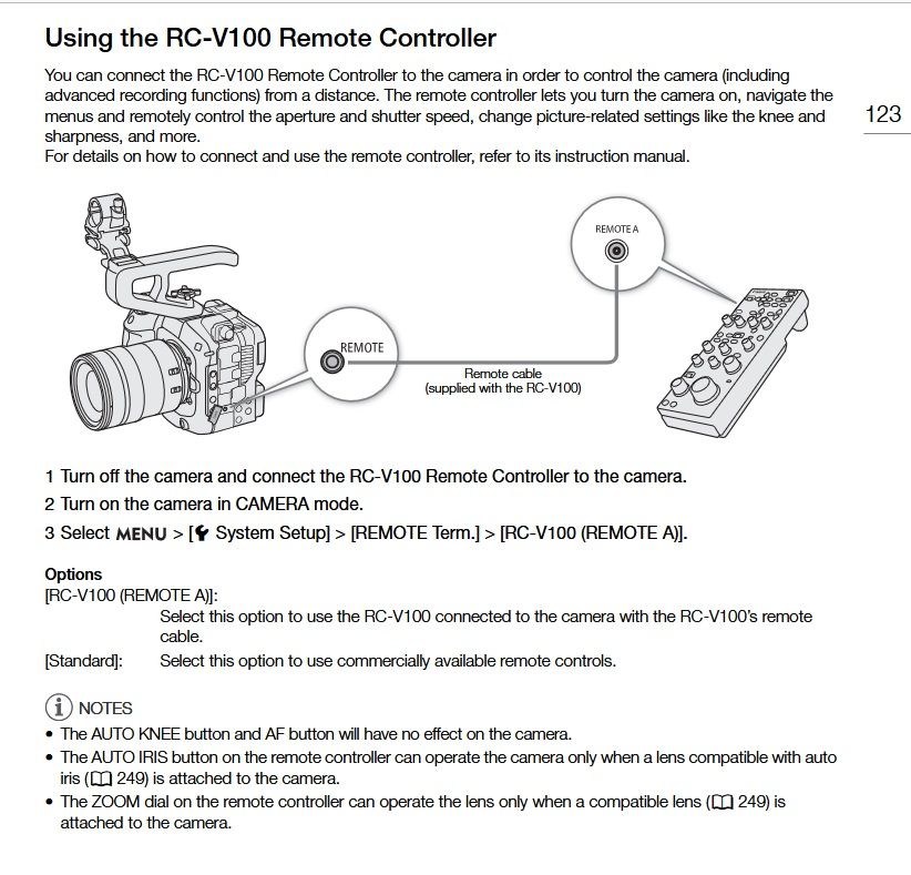

However, thinking about those cheesy one-button wired remotes, it seems to me that they aren't actually LANC controllers -- they just short two wires, or something, to trigger the camera.  I guess the C80 isn't looking at that?  The C80 manual is totally hopeless here -- what the heck is "commercially available remote controls" supposed to mean?
The manual doesn't mention LANC at all.  Maybe because Sony invented it?  So I don't know if the C80 uses LANC, but I guess I'll find out.  I've ordered an actual LANC controller, and we'll see if that works.  Gets here Tuesday.

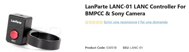

Oh, let's hope it will work - let me know, please. Mine one-button Lanparte (which was fine on Eos C100 mkII) doesn't fire with c80...  lanparte.jpglanparte.jpg
