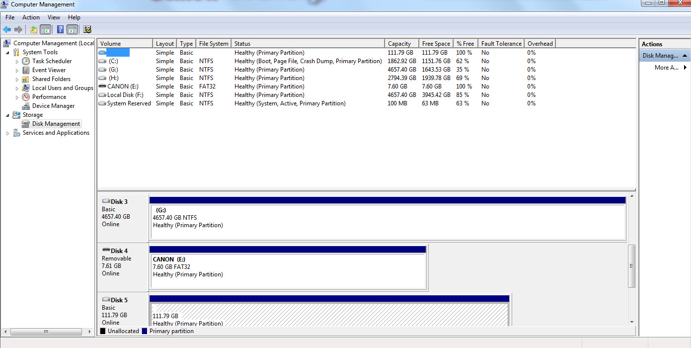

Thank you for the screen shots.
I see the dilema. It looks like it is showing as 2 drives in device manger but only as one in Windows Explorer. In Windows Explorer it looks as though there is nothing on the drive (Canon E: 7.50 GB free of 7.50 GB). Drive E: is probably showing an 8 GB SD card. Do you have an SD card inserted in the camcorder?
What do you see if you go into Disk Management? If the ImageMixer 3 software is reporting on the right drive (camcorder's internal drive) then it appears as though there is nothing on the drive. I can't say for sure whether or not it is reporting on the correct drive. In Disk Management both of the camcorder's drives may appear and if so then you would able to tell more from that than anything reviewed thus far.
06-19-2017 04:51 PM
Yes I do have a SD card in the cam (8GB) It seems that it detect only the SD card, not the hard drive on the cam. I have 31 GB of videos on the cam.(They are all there when I power up the cam without the USB plugged in). Here's a snapshot of the disk management
