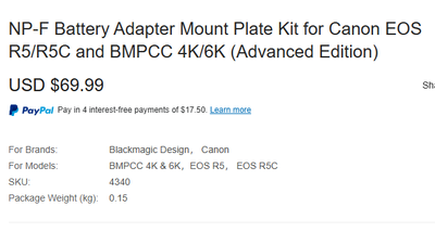

09-30-2024 04:31 PM - edited 09-30-2024 07:46 PM
Hi Yuli,
It looks like you need the "Advanced" battery plate model for the R5 C. The specs also say it supports connection to a "dummy battery"
1. Compatible with NP-F type batteries, paired with DC to LP-E6NH dummy battery power cable, providing external power supply for Canon EOS R5 / R5C, BMPCC 4K / 6K and various mirrorless cameras
The older NP-F model does not appear to support this body. Neither may be compatible with USB-C PD (May require dummy battery)
