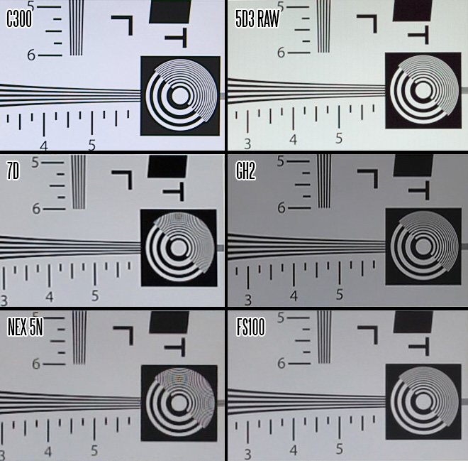

In the battle of the 1080p cameras, the game has changed. Here’s how the 5D Mark III in raw recording mode compares to the best 1080p output from the Canon C300 and 1D C.
The Canon C300 is a very good albeit highly priced $15,000 HD camera, producing an ultra clean and detailed image by oversampling from the same 4K sensor as the C500.
It is the current benchmark, so interesting to see how close the 5D Mark III raw gets in 1080p.
ue to the way the crop mode framing works in the current Magic Lantern build we couldn’t do a final 100% perfect chart test for the 1:1 mode so please treat that last image as a work in progress not a final result!
The Panasonic GH2 is third best on this test, certainly closer to the C300 and 5D Mark III raw than the other cameras, which is astonishing considering the price difference.
The 5D Mark III is slightly cleaner than the GH2, with less aliasing, especially horizontally but it’s still a good result for the GH2.
The Sony FS100 seems to have a soft default output and a strong anti-aliasing filter. The 7D and NEX 5N are a big step down with plenty of moire.
To summarise, I’d put the cameras in order of resolution at 1080p as follows:
I’d tentatively say the 5D Mark III in raw 1:1 crop mode has the Canon C300 beaten for resolution, but more development is needed with Magic Lantern before we can say for sure with any finality. For all I know they could have a Super 35mm 4K crop working eventually, it’s too premature to judge the final resolution of the crop mode. Exciting times ahead!
