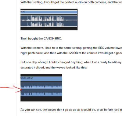

With that setting, I would get the perfect audio on both cameras, and the waves would look like this:
The I bought the CANON R5C.
With that camera, I had to to the same setting, getting the REC volume lower (aroung 10/12) to get ride of the noise hight pitch noise, and then with the +20DB of the camera I would get a good rec audio.
But one day, altough I didnt changed anything, when I was ready to edit my new video, I foud out my audio was saturated / cliped, and the waves looked like this:
As you can see, the waves don t go as up as it could be, or as before (see my first screenshot).
Now, with more testing, I found of that the REC VOLUME setting of the camera lower of course the input sound, but also lower the audio limit, which doesnt make any sense. Because I do get less volume but because the limit is also lower my audio will be saturated / cliped.

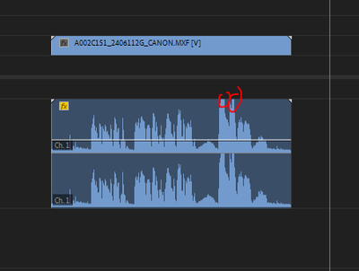

That why i want to know if you have the same issue, when putting the audio level at 10 you have clipped audio, and you have something like that:
06-10-2024 07:02 PM
Normally you have a clipped audio when it is like this:
So to avoid that you lower the levels on your camera or mic. ok.
But how come I have clipped audio like this:
06-10-2024 07:21 PM - edited 06-10-2024 07:21 PM
