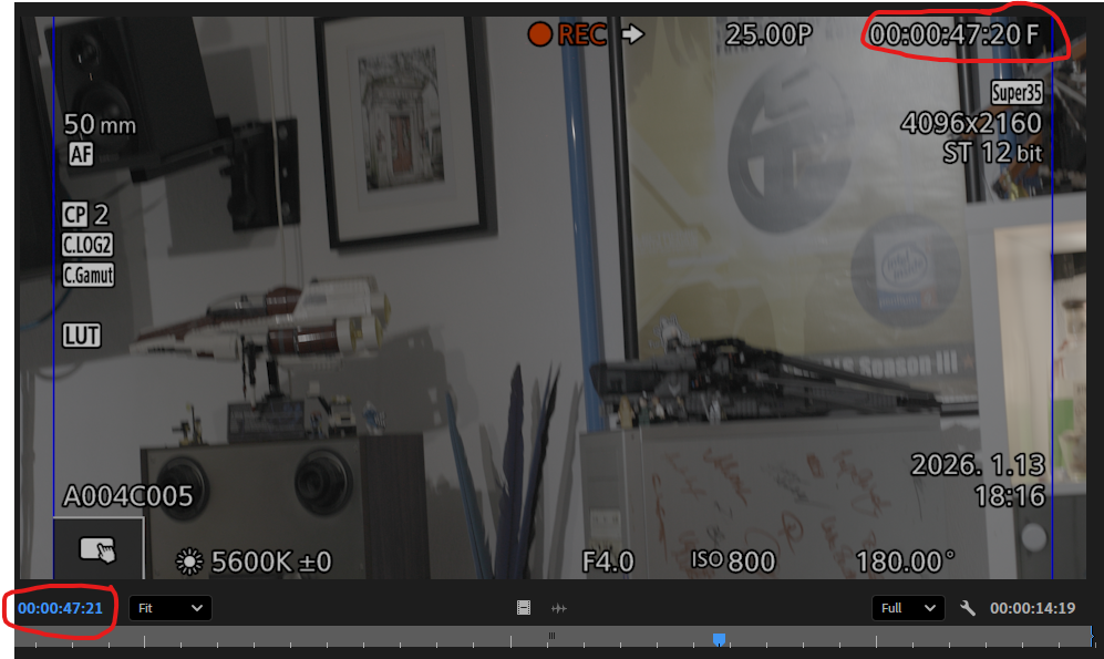

Hello, I noticed a minor technical inaccuracy with my EOS C70 and wanted to know if this error occurs with other models in the C series. I connected an Atomos Ninja V to my camera and recorded the HDMI image via the Ninja V in addition to the internal RAW recording. I want to use the Ninja V recordings as notes and for logging the settings. I also have the camera's HUD on the Atomos recording. I synchronised the recordings in Premiere using timecode. I noticed that there is a timecode offset of 1 frame between the internal recording and the Atomos recording. Since I also recorded the camera's HUD, this offset can also be seen when comparing the timecode in the image with the timecode of the file. I thought it might be due to the Atomos and tested the same setup on my 5Dmkv and XF205. I don't have this problem with either of these cameras. Now, out of curiosity, I would like to know whether this error occurs with other models in the C seriesThe timecode of the file can be seen below. The timecode of the recording is shown at the top of the image.
