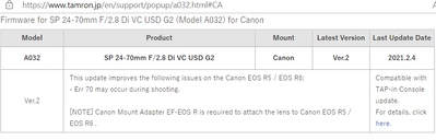

Tamron isn't great about putting out updates. If you have a Tap In console, ensure you are running v2 of the lens FW. This FW is not R5 C specific (the R5 doesn't have a Cinema OS), but it wouldn't hurt to try it.
