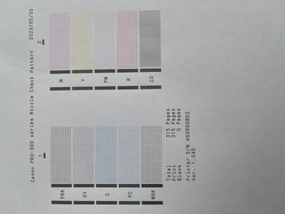

Hello,
I have problem with prints, on some dark colours prints appear white faint line, always in the same point, across the whole picture.
print head cleaned already few times. All inks replaced three months ago. Nozzle check pattern shows that CO colour doesn’t have horizontal white lines as should have, how can I fix this?
Solved! Go to Solution.
05-09-2023 09:40 AM
I was just about to update the post. I decided to look inside and analyze the technical condition. There was light soiling on the timing strip. This could be caused by a paper jam and my inability to pull it out. I cleaned it with a cotton swab soaked in glass cleaner. The problem is gone.

05-09-2023 09:41 AM
The problem is solved, it was dirt on the timing strip.
05-09-2023 09:40 AM
