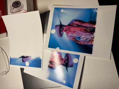

I have a Canon Pro 1000 that I recently moved to a new home with. Before, I had it set up wirelessly with my MacBook and it would print fine. I now have it set up on LAN with my Windows 11 desktop and I can’t get it to finish a print. No error code comes up, it just ejects the paper and goes to “ready to print” Home Screen. I’ve tried swapping out Ethernet cables, going through the print head cleaning, print head calibration and print head alignment but the issue is consistent. It hasn’t finished a single print.

I switched to a USB connection and now the printer is working. Thank you.
01-26-2025 04:50 PM
Since you previously used it wirelessly, you may need to delete that connection and establish only a LAN. I have heard that a conflict can arise otherwise.
01-26-2025 05:58 PM
