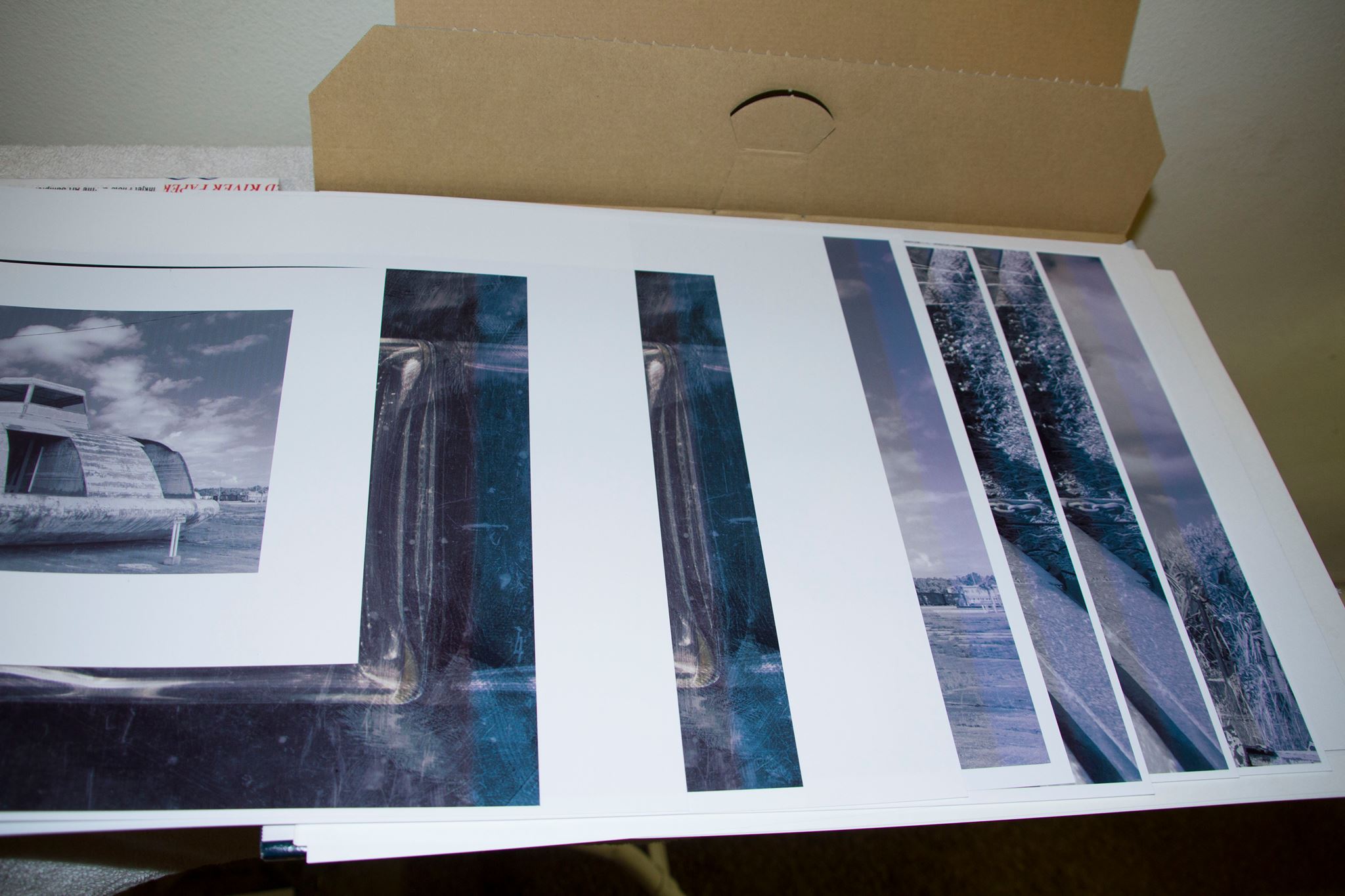

I'm currently a photography student purchesed this printer in order to produce my homework assignments and personal projects.

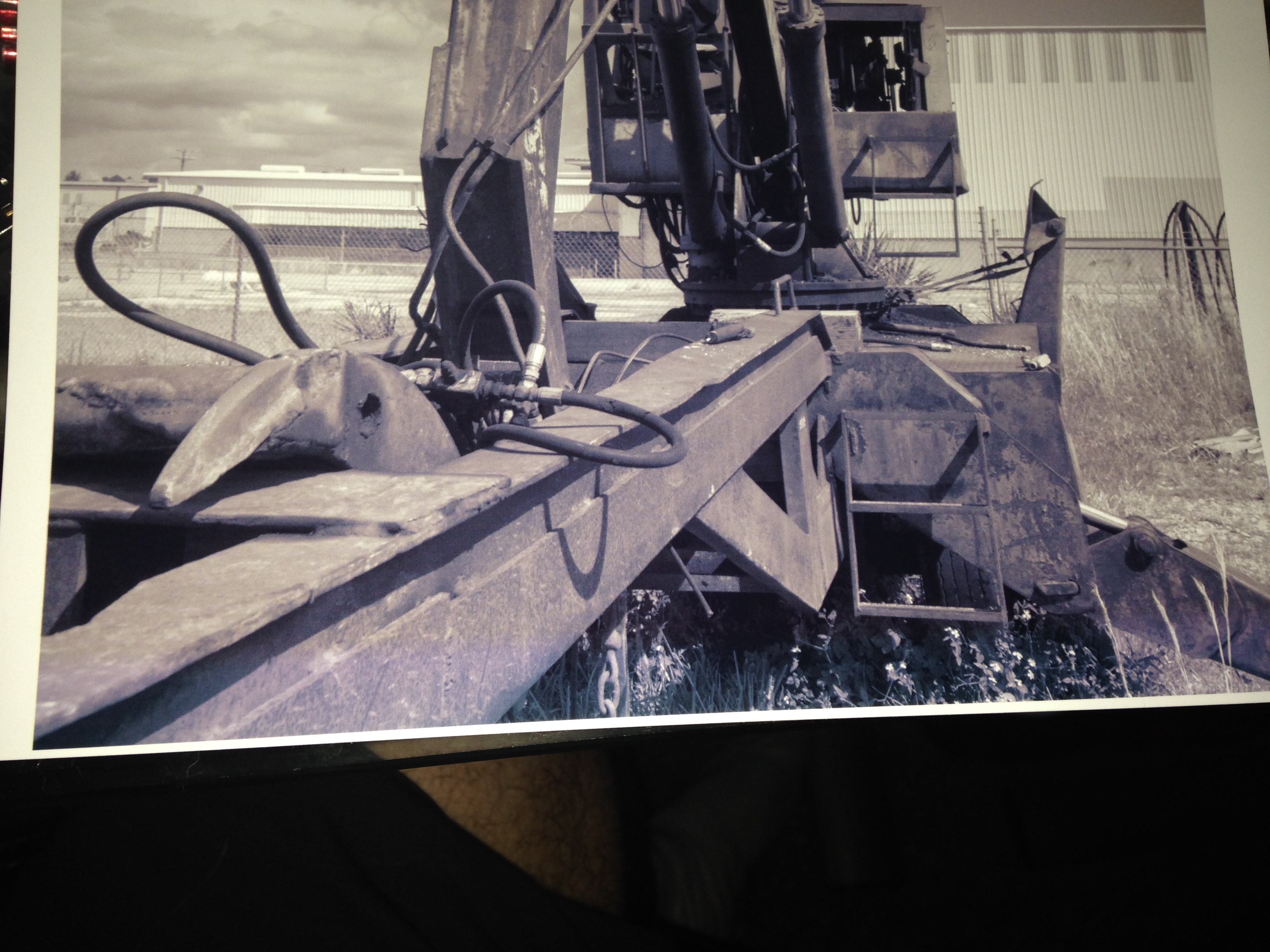

currently, my printers has begun adding a band of color at the end of my larger prints...no matter the size or the paper, it routinely looks like it lifts off the yellow in the same spot, with the same consistancy and the same size on the bottom of all of my prints. i've done multiple cleaning and nozzle checks...the ink is new, adjusted ICC profiles, nothing seems to matter. it appears to be proportioned to the size of the print itself...because even on an A4 sheet of paper, there is a small band and the print just seems to "give up" and rush through the rest of the print.
i've enclosed an image of the 13x19 and 11x17 prints as well as an 8.5x11 i just took at the time of this mailing. since i seriously need this for school, i was hoping someone can help me with a hopefully simple solution.any advice?

that isn't the issue...if you look at the photos provided, the whole start of the picture is fine. the color band at the end only shows up at the end of the photo, no matter the proportions. 8.5x11 to 13x19, that band appears at the bottom of the last portion of the photo as it's printing
