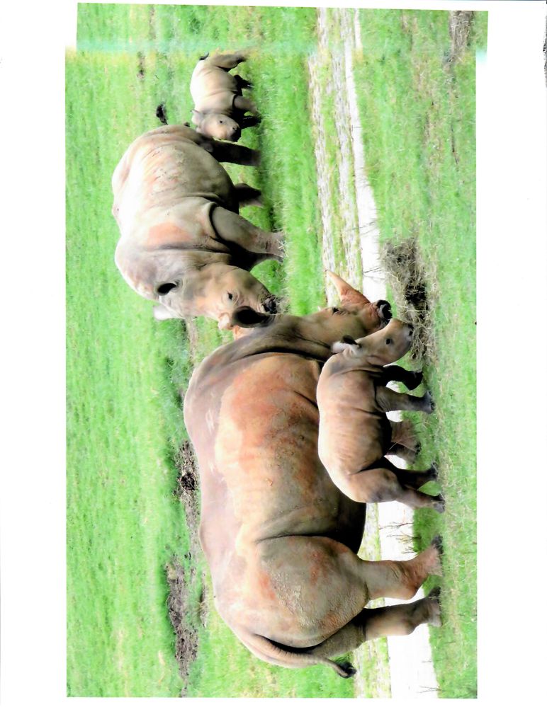

I have a Pro300 that has developed a problem when I try to print letter sized. It prints correctly for the first 10 inches and them it clatters as it prints and prints the last inch offset by about 0.25 inch, with a muddled band between. I have installed the most recent driver and it doesn't seem to make a difference what program I use to print. scan of a print attached.
Suggestions appreciated.

What tray are you printing from? What paper type?
08-01-2023 09:08 AM
Auto (top) feed. Glossy paper, highest print quality.

Hi. If I follow everything correctly it seems the problem is with that specific Red River paper. Am I correct?
If so, maybe contact Red River.
08-07-2023 04:08 PM
yeah. It may be due to a bow in the paper. Currently playing with removing bow and printing. At first try, that seems to have corrected the problem.
