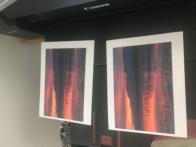

I just tried landscape orientation and the narrow edge is still there - wide edge is down. I also set the paper size to A4 25 this time. See my photo showing how the print came out of the printer...
thanks again,
