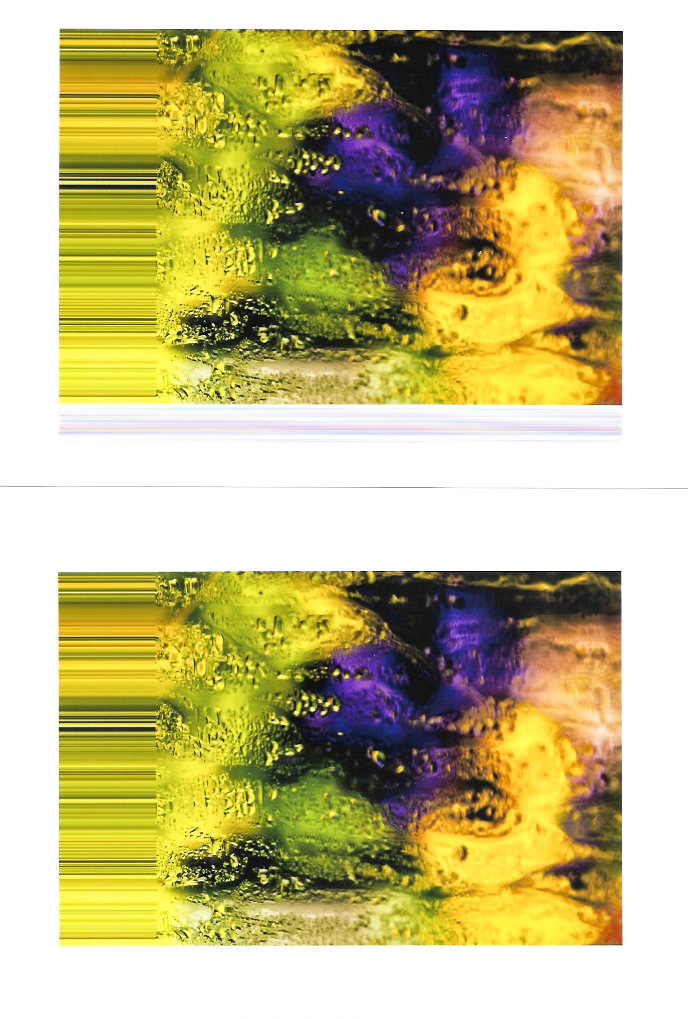

Printing streaks on the side (1/2 inch) and bottom (1 inch) of print using colors in the photo. Called Canon support last week and agent (after being transferred 2X!) had me remove the Pro-100 from the list of active printers/scanners in Apple Preferences (Catalina) and then add it back, which fixed the problem all week. The agent assured me it wouldn't happen again. But, of course, it did, this morning, after not using the printer for a couple of days. Installed the firmware update and am not sure if that has anything to do with it. The agent said no. Haven't seen anyone else with this problem.canon pro-100 samples.jpg

Thanks for the reply, John, and the welcome. The images I attached to my initial post were printed using Canon Print Studio Pro, but I also printed using Photoshop with the same problem. I use a USB connection and I double-checked the paper to make sure I had the right side up. I used Red River Arctic Polar Satin paper which is pretty easy to tell the front from the back. I also unplugged/re-plugged the printer, did a nozzle check, printhead cleaning (even though it wasn't necessary), and printhead alignment. Any ideas on what to try next besides taking a hammer to it would be very much appreciated.

I installed the IJ Series driver as you suggested and then printed a different image, of which I got 2 good prints. Yay!! Then I tried printing the initial image I had the problem with, which, unfortunately, printed with the streaks again. When comparing the two images on PS, I noticed that the troubled image had 0 layer and no background layer, while the image with the good print actually had a background layer. When I changed the o layer to a background layer on the image that was giving me the problem, I was able to get some good prints with no streaks. I don't know if this is the ultimate solution, but I'll take it for today. Thank you, again, John, for your help. If this occurs again in the future and I get any new useful information from Canon support that helps, I'll share it.
