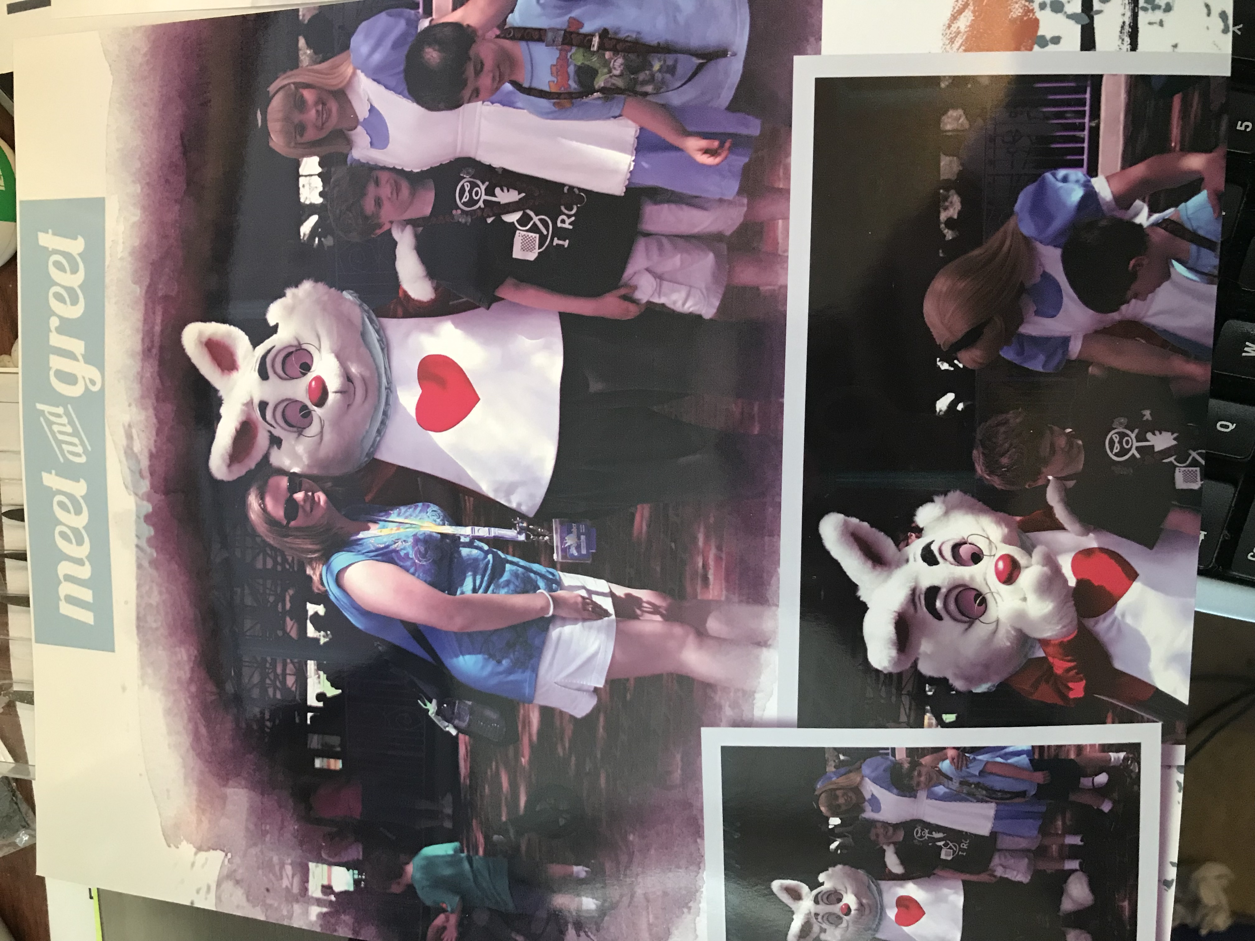

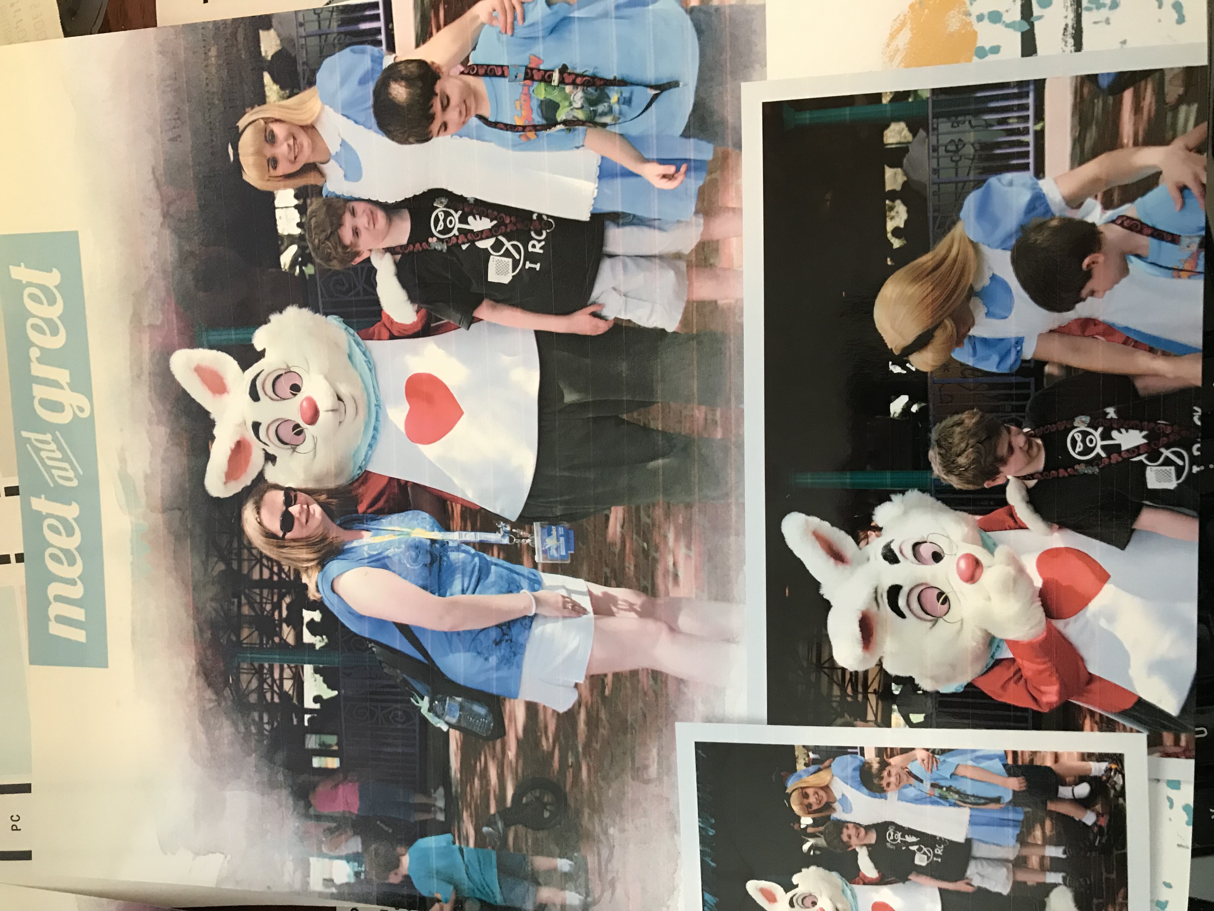

I have a Pro-100 that I'm working on some prints for. I've honestly have had just over a year and rarely use it. Everytime I seem to be fighting a color issue with it. A lot of my prints come out with a very bad magenta tint to them. I've gone through hours of settings. I do my printing from Photoshop CC currently for the most part, but even just printing from Windows photos the results are the same. What I have narrowed down is that it resolves around selecting photo paper in the Printer settings. The photos come very dark and reddish. If I select plain paper the photo color looks great but it has some lines running through it every 1/4" or so. It's that way whether I use actual plain paper or photo paper. Obviously it's getting very expensive to burn through ink and paper trying to figure this out and I've probably printed 2-3 dozen pages trying to get it worked out. I could use any help possible. Print Preview is turned off Drivers have been uninstalled, reinstalled several times. As well I have two seperate PC and I get the same results from both them. Both images are printed on photo paper regardless of the setttins.  I've tried in Lightroom as well with the same results as well as using the Canon Printing plug-in.
Set Photo Paper
Set to Plain Paper
