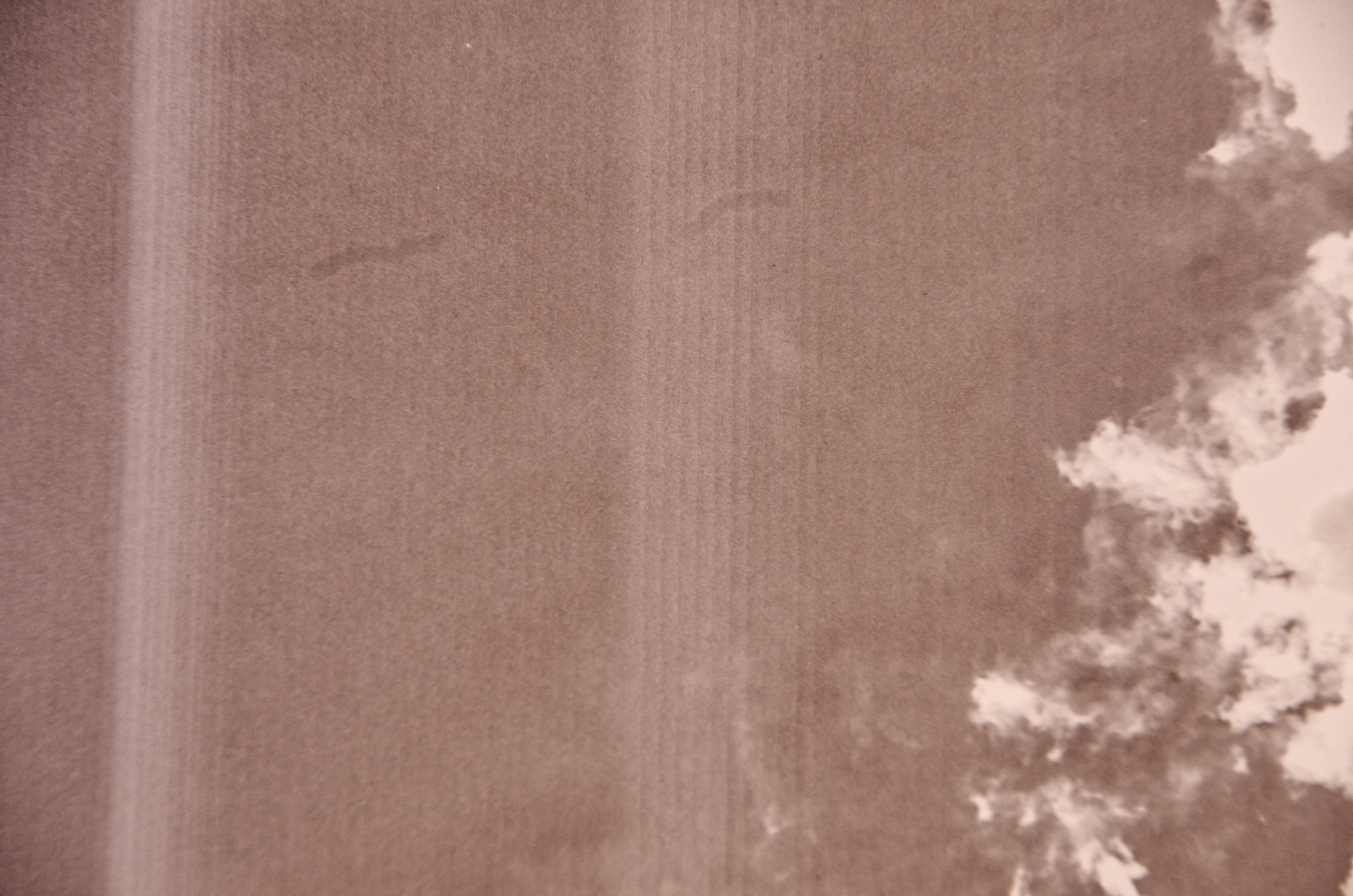

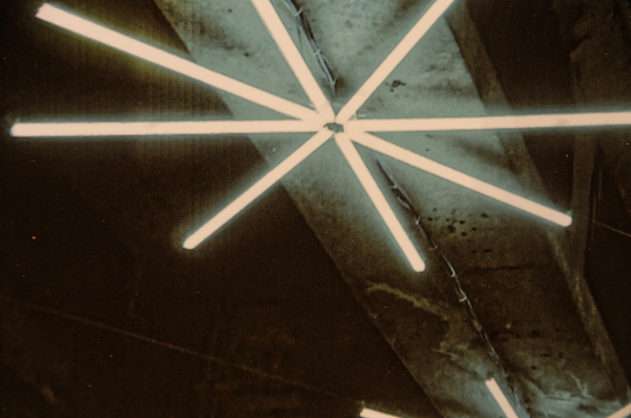

Hi. So I'm having an issue with banding on my print. The degree of visible banding are dependent on the picture and on the size of paper used.
I noted that the problem only occours when using a profile for glossy or semi-glossy paper however the banding are consistenly wrong (exact same banding when printing the same picture on the same size paper).
This leads me to believe that its a software issue!
I have tried upgrading/downgrading both firmware and drivers, both with no prevail.
I have also tried using both comparable Canon ICC-profiles and original profiles from the paper manufacturer.
Furthermore I have done a cleaning cycle on all the nozzles and aligned the printing head. Testpages looks fine.
I have attached some pictures of the prints with banding, both overall and close-ups.
Can anybody explain to me what the problem is? - I have been trying to fix it for a couple of weeks now and I don't know what to do anymore.

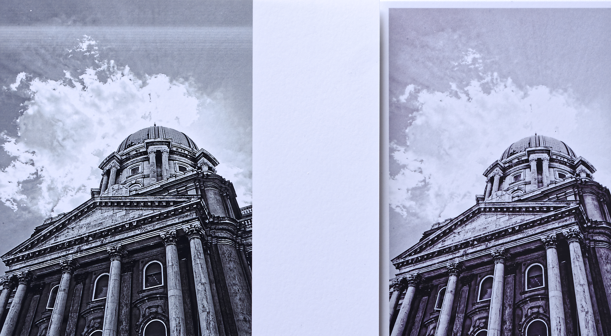

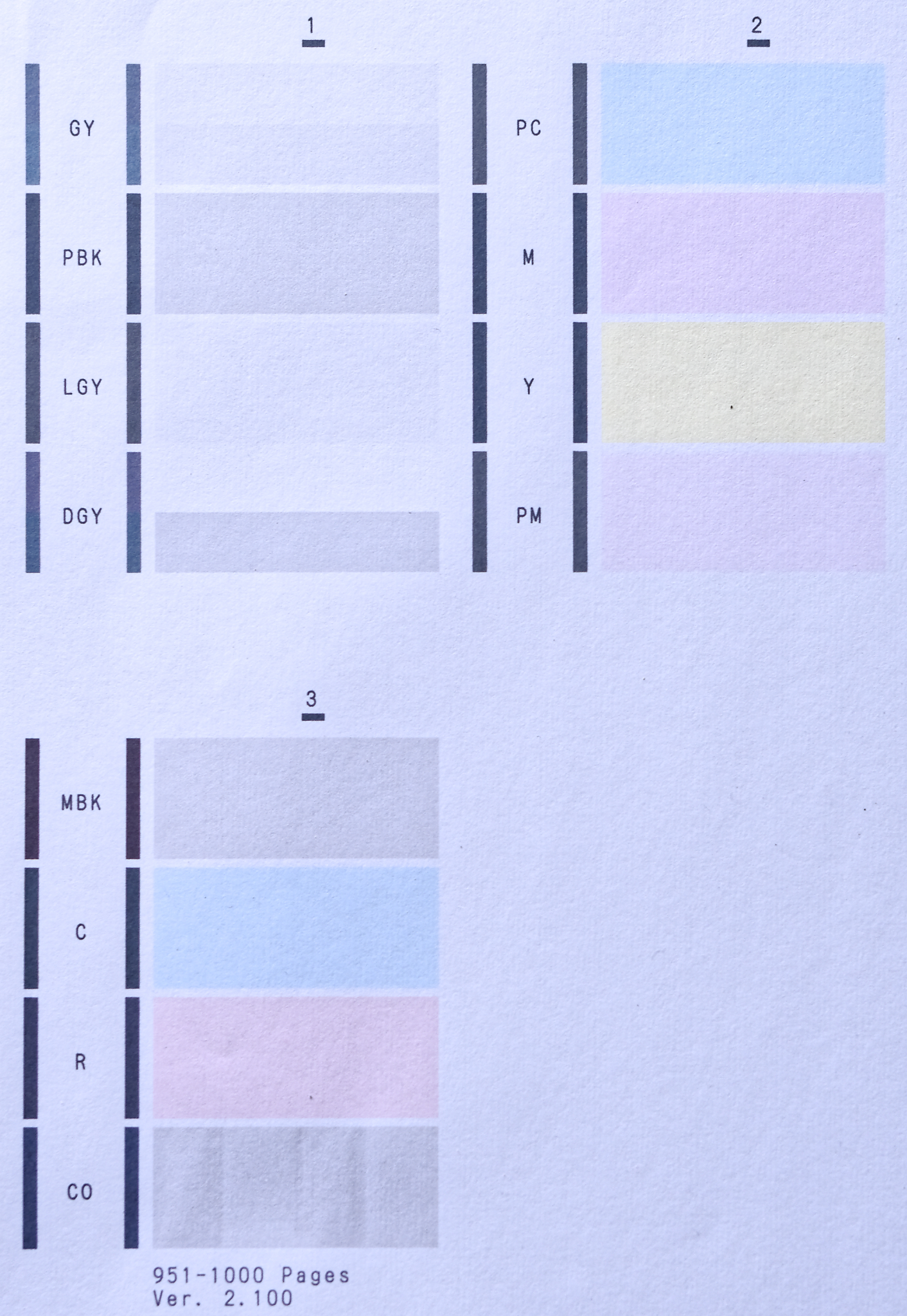

None of thoose suggestions fit the description I made.
I wish to post this nozzle test and a comparison of one of my photos using a printer profile for photo paper (left) and one for common paper (right). As you can see the banding does not occur when using a standard profile for common paper.
