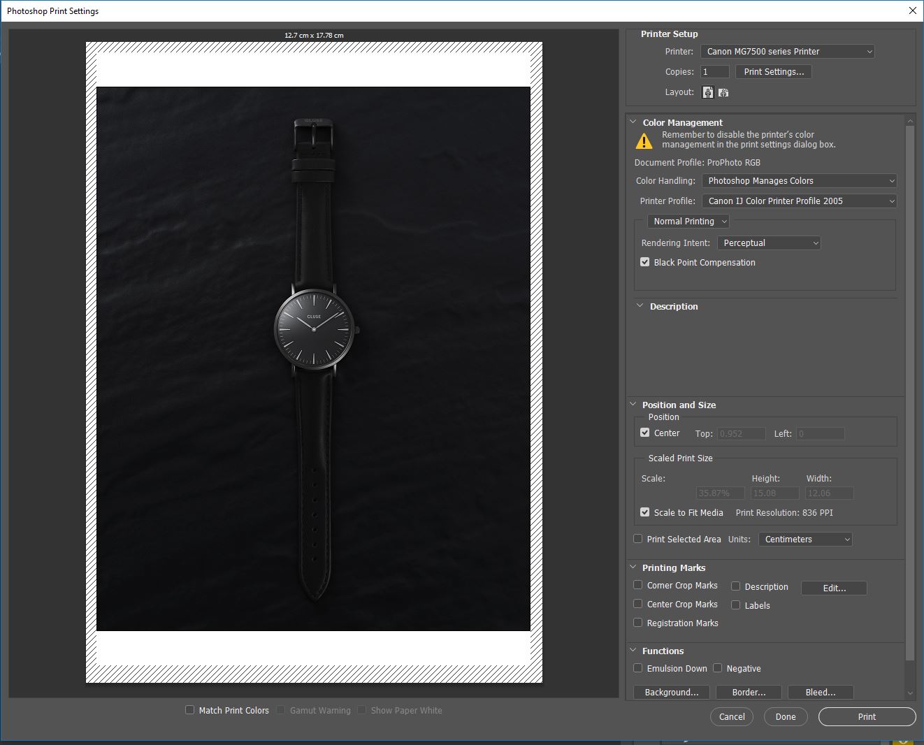

I know this is a very common issue but I was still hoping you guys may be able to help.
I'm a pro photographer with a good understanding when it comes to profiling my monitor and an OK understanding of printer profiling. I print all my work using my lab and only tend to print documents and the occasional shot at home. Photo's printed at home are more for reference / checks and hence 100% colour accuracy is not too important but luminosity / brightness is.
I got a Pixma 7550 a little while ago but have only just used it to print a test. I've found the image extremely dark compared to my monitor. I don't expect it to be perfect but it required a 2 stop adjustment in Photoshop to get the print close in luminosity to what I see.

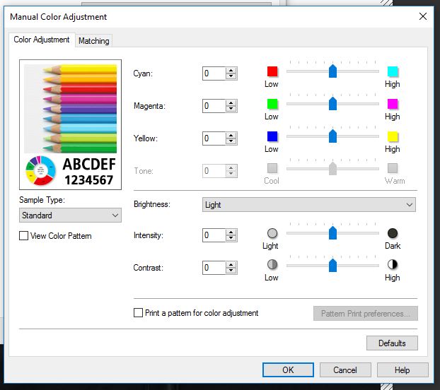

By adjusting the Colour / intensity to Light, the images were pretty accurate but I wondered if there is anything obvious I'm doing wrong.

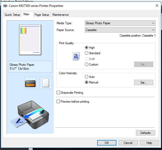

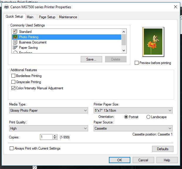

Here's some screen grabs of the print settings:
Thanks!

What is the setting on the tab "Matching"? It looks like you have selected "Photoshop manages Color" in which case Matching should be set to "None" and you need to select the paper ICC profile in Photoshop.

The one screen I missed! Ha ha. Thanks so much. That sorted it out.
In terms of ICC, I don't have one for this paper nor the means to create one. I've found the one I currently have selected works best. It's close enough for my home test prints.

Does the paper manufacturer recommend a Canon media type?

I'm ashamed to say it's just a cheap paper off Amazon. As I said, anything I need properly printed goes to my lab. The prints I make here are just another way for me to analyse my edits. I often find that by printing I notice other issues which may have been missed in PS.
