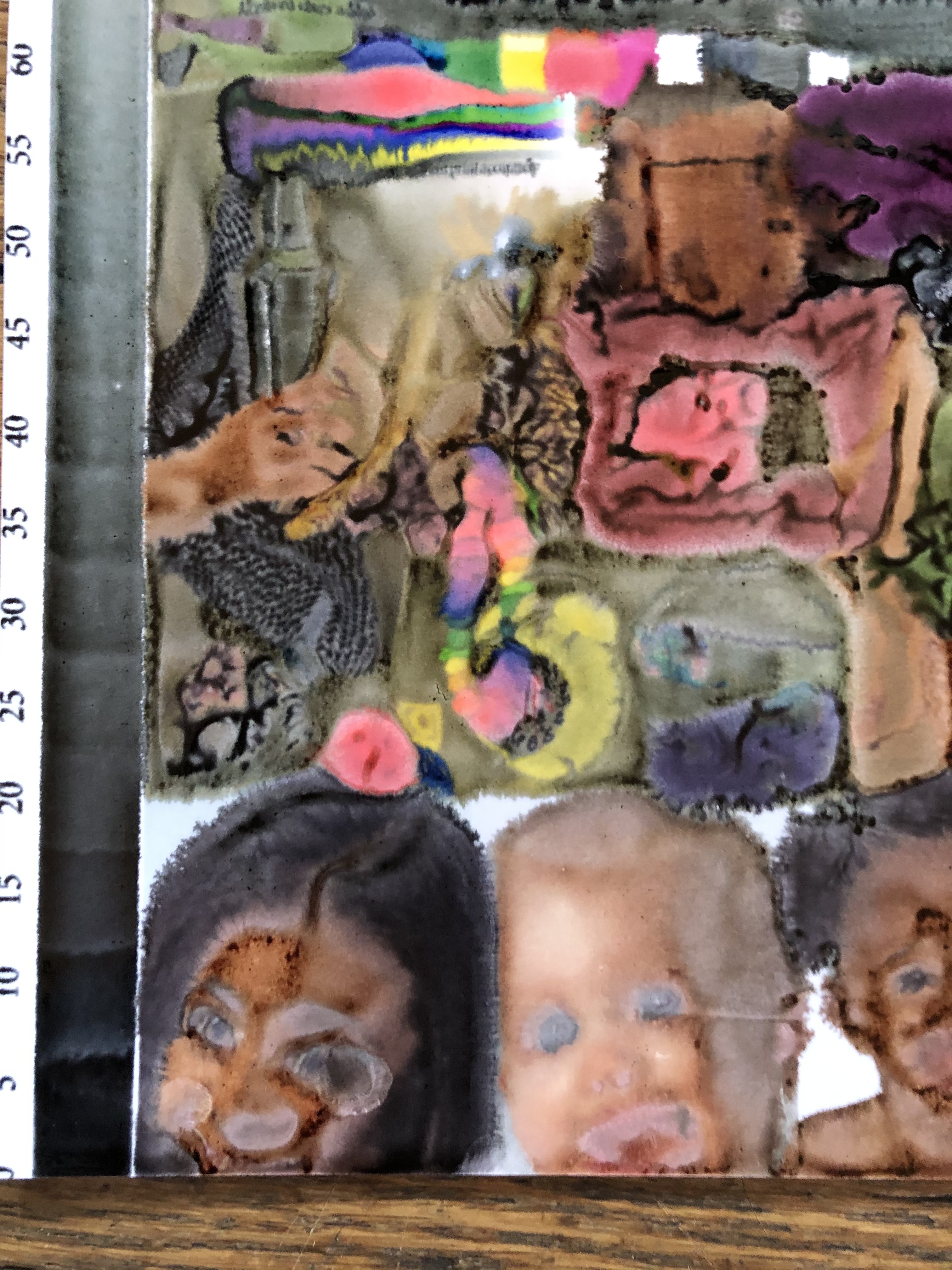

I did download an image similar when I was on with support but the glossy paper had wet ink smudges all over it and I tried 3 times. Support insisted that I was printing on the wrong side but I pulled it directly out of the package and inserted it right into the feed. That one didn't work so the next one I took right from the package and flipped it over before placing into the feed.
Does this printer only work with Canon paper? I was selected the greeting card option from the print settings because I'm using cardstock cut to greeting card size.

What you are describing is classic of printing on the wrong side of “plastic” coated papers. The non-print side is non-absorbent. Very strange that it happens on both sides.
I just read your post again. Sounds like you are using non-photographic card stock. What is most likely happening is the ink is being heavily absorbed into the card stock. Put a little drop of water on the paper and see how it spreads out.
If you want to check how the printer is performing print a test image on photo paper.
You might have better luck with your cardstock by selecting matte paper as paper type. Even then it might not work as you want.
