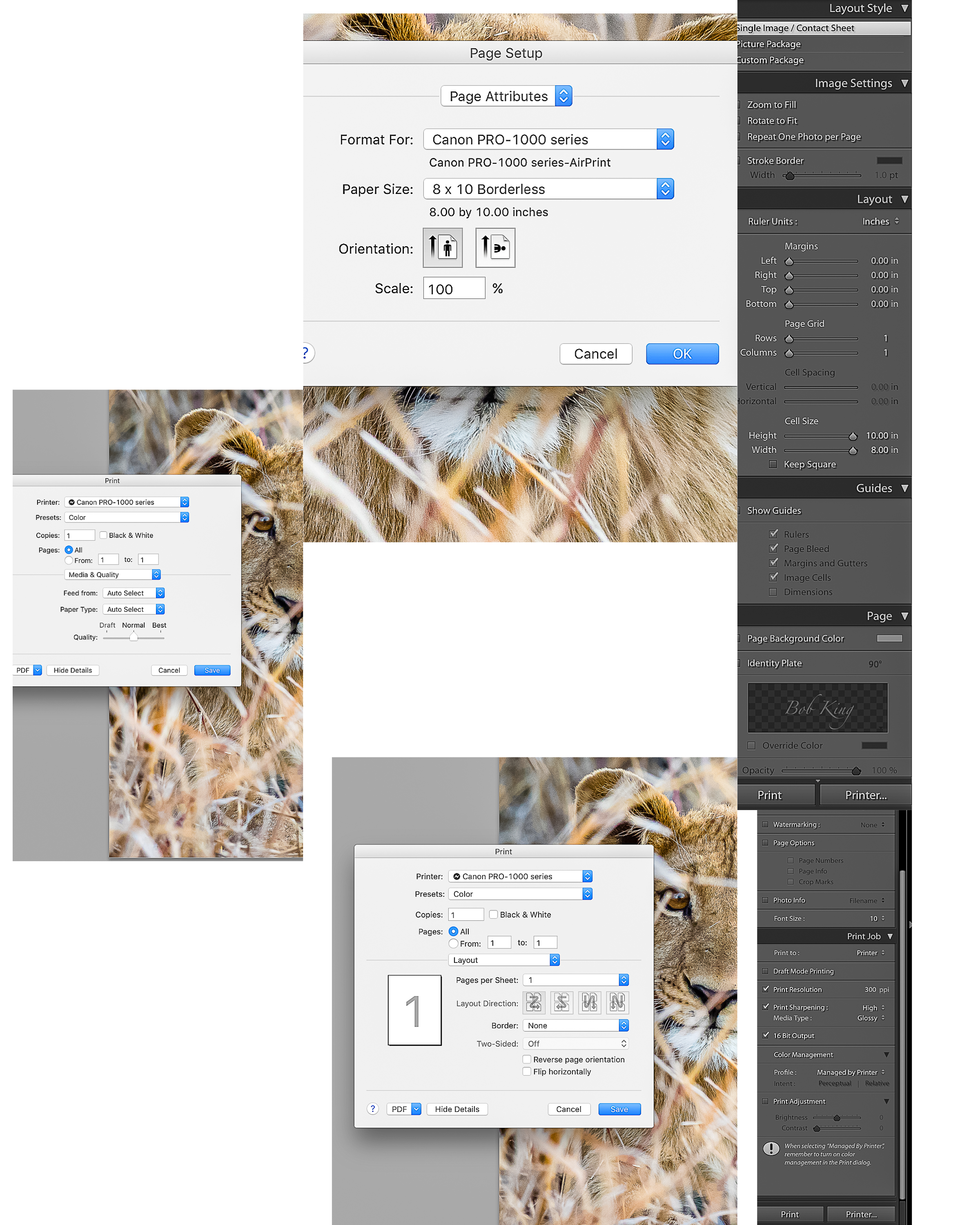

Thanks John - here are the print settings. And excuse if this comes out really large or anything odd. I appreciate any thoughts, and will also try PSP.
Looks like you are trying to print borderless. Borderless will overspray a little to be sure you cover the whole page.
See this thread: http://community.usa.canon.com/t5/Professional-Photo-Printers/printing-issue/m-p/163503#U163503
You also need to be sure that you crop the image to your paper size - I can't see all of your settings without downling image and opening in another software, which I will do and comment further.
I can't make out the LR panels - too small and gets pixilated if I try to enlarge.
Assuming you cropped the image to 8x10 before you printed then the issue could just be the overprinting.
I also noticed that you are using the AirPrint version of your printer.
If the PRO-1000 is similar to the PRO-100 which I have, then you want to be using the IJ Printer version. Go into Printers & Scanners and press "+" and wait awhile and you should see the IJ version appear. If you didn't install IJ Network driver from Canon do that first.

Thanks John - I will try printing with border and see if that makes a difference, and check the other suggestions and repost the print settings:
It was the overspraying - thanks John. When I used borders it printed perfectly fine. So a newbie question for you then but does that mean that if I want to print a 5x7 I should use 8x10 paper and cut it down to size?
l'm basing my answer on my PRO-100, but the printer driver will allow you to reduce the amount of extension; you could try that.
