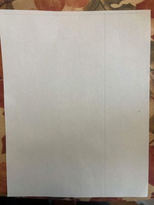

Whenever my PIXMA MX922 prints something, the print has a black line on the back (pictures attached). Sometimes it even has black ink splotches on the bottom edge of the paper but that's been happening less recently. It's probably a result of ink spilling in the printer, since this problem started right after.

Example of the line
Zoomed in

Hello, sorry for the late reply and thank you for helping me with this issue. I ran a Cleaning for the printer head according to the maintenance menu. When I did a test print after, the front had two ink lines: one vertical and one horizontal, with the horizontal line near the top edge (picture attached). I also cleaned the bottom plate and the scrap paper came out with an ink streak. I then left it alone for a little and did another test print. This time the paper only came out with an ink streak on the back of the page. Should I try a deep clean? I'm not sure that the problem has anything to do with the printer head...
Test Print After Cleaning
04-20-2026 12:24 PM
I think you are correct, this is not a printer head issue. Some very straight parts of the paper feed still have ink on them. I suggest you purchase some cleaner sheets and run them through the printer they should pick up the remaining ink. They are available on Amazon for a low price.
