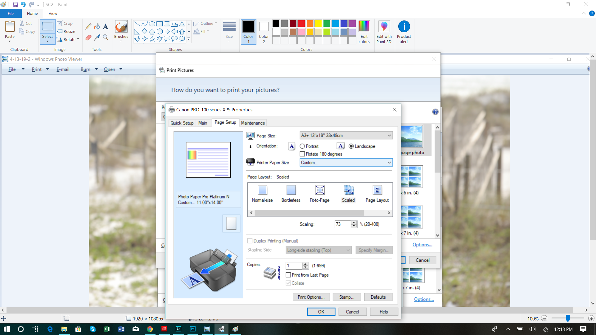

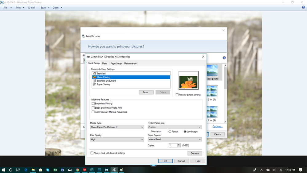

If I open with WIndows Photo Viewer to print from there, go to print, go to Options on bottom right
then, printer properties:
Then I go to Page Setup and choose the following...I have the paper size at A3 - 13x19 and then choose Scaled and a custom setting of 11x14. I do the same thing for 8.5x11 except choose the 8x10 setting instead of custom. either way, the same problem occurs.
In Print Studio Pro - I go to File, Print and then choose Print settings and the "Canon Pro-100 serires XPS Properties" box like above comes up for same settings.
"either crops the photo or prints the print too small"
