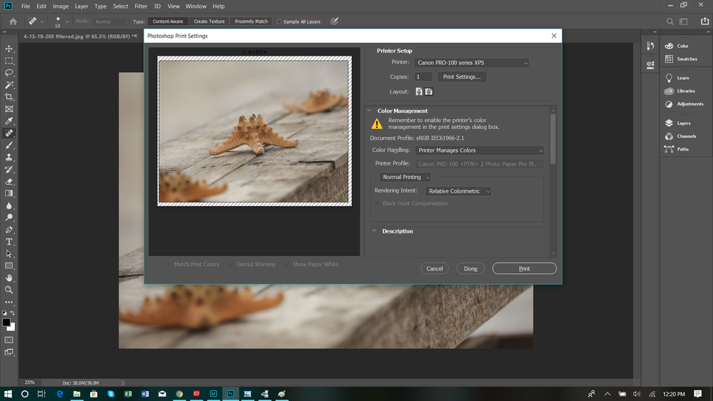

Can you post a screen shot of your settings?

If I open with WIndows Photo Viewer to print from there, go to print, go to Options on bottom right
then, printer properties:
Then I go to Page Setup and choose the following...I have the paper size at A3 - 13x19 and then choose Scaled and a custom setting of 11x14. I do the same thing for 8.5x11 except choose the 8x10 setting instead of custom. either way, the same problem occurs.
In Print Studio Pro - I go to File, Print and then choose Print settings and the "Canon Pro-100 serires XPS Properties" box like above comes up for same settings.

"either crops the photo or prints the print too small"
It looks like your original photo is a 2x3 aspect ratio.
If you want the short side to be 8 inches then the long size will be 12 inches. If you try to print 8x10 then it will crop off two inches. You could resize to have long size 10 inches; then short size would be about 6 5/8 inches.
Similar problem would occur if you try to fit it into an 11x14 opening.
You could edit the print to 8x10 or 11x14 aspect ratio.
You could print it 12x18 on A3+ paper with 1/2 margin all around, if that's not too large.
