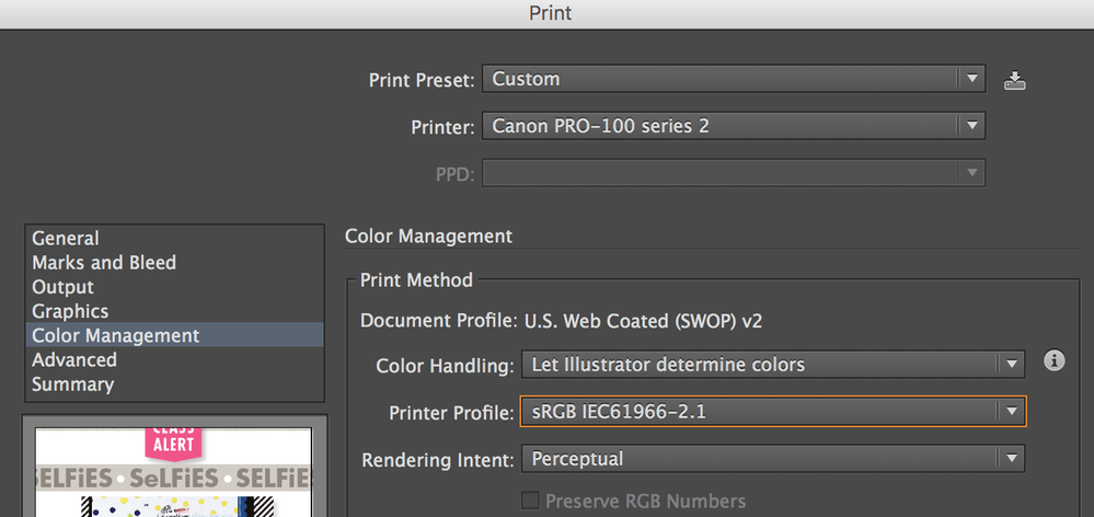

These are the settings I have set up....
In ILlustrator this is the color management info I get ---Screen Shot 2016-05-26 at 10.31.13 AM.pngIt's this "Printer Profile" drop down that I think is the issue - but there's 100's of options - at one point I thought someone mentioned to have it selected as "display" which I've done with the same results......

Settings look OK. Give Canon a call at 1-800-OK-CANON.

Been reading this but I am not a Mac uses so I have little to help.  But for sure, are you certain your monitor is not set too bright or the contrast is way off?  If you exaggerate the brightness in PS or Illustrator does it brighten the print?

What I was getting at, the printer may be doing exactly what you are telling it to.  Most of the people that I have helped with a Pro-100 or even the earlier versions were for 'print too dark'.  The overwhelming cause is the monitor set too bright.
