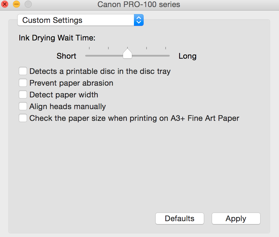

First off you must not let the printer set anything. Turn off every bit off control it has. You can do this with the Canon My Printer under the Printer Settings tab. Do you know how? I will guess, yes, for now but if you don't get back to me.

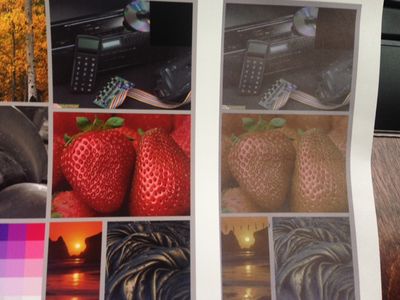

Thank you, ebiggs1. Going in and changing the settings to not let the printer control anything fixed it! Made a WORLD of a difference. Comparing the two prints side by side, its almost like the printer was putting a shade of black over everything. I've attached a picture of the difference. I know it's hard to tell being a picture of a picture, but you can see the difference! Thanks so much for your help.
