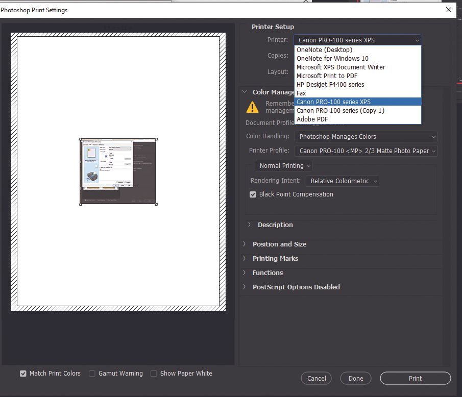

3. can you post a screenshot of your Photoshop print dialogue display showing the settings?

I am just using it for printing on sticker paper, regular paper, and card stock paper for packaging some items for craft fairs, not photo paper.
I just updated the XPS Driver yesterday but I am still getting two printer options to print from.
07-20-2022 05:44 PM
The XPS version of the driver is seen by the computer as a separate printer, so you will have the Pro-100 and the Pro-100 XPS.
If you have some Canon photo paper you should try printing on that, using the corresponding media type, for test images. Dye ink printers are really made for printing on coated photo papers.
