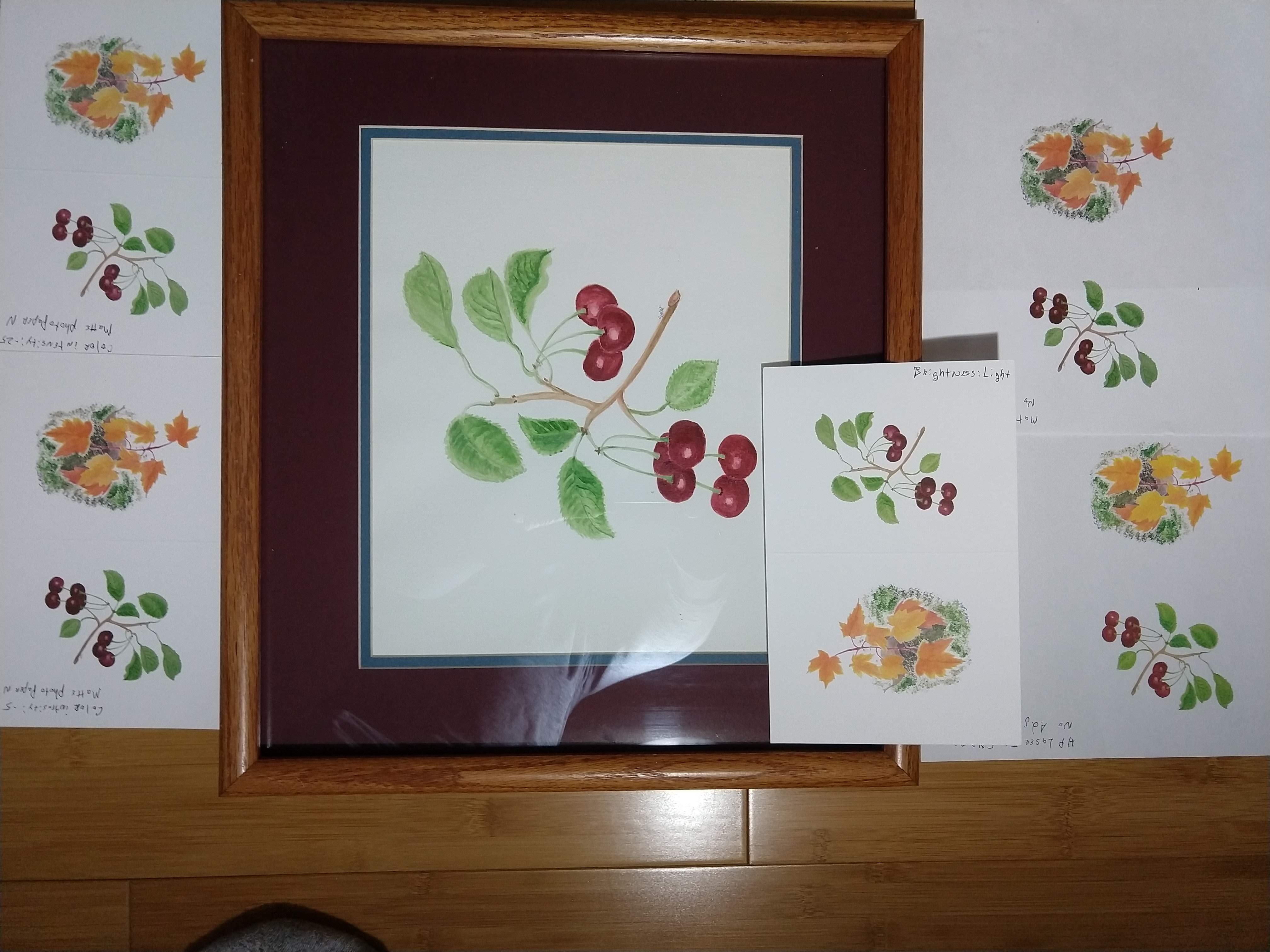

I have a number of digital photos which I am using for notecards.
The short version of my problem is that when I print on a Pixma Pro 100 it's darker than on an HP Deskjet F4280.
It's close, just a tad darker.
I have gone thru documentation and calibration (a number of times), but it feels like I'm missing something.
Have done printing the test pattern and it looks ok.
While I could send along images, that would take some picture taking and I thought I'd start with a text description.
Using Win 10 with Word 2016. Letting color management do the default.
Have also tried with PS CS2, with similar results.
What am I missing?
TIA --Dirk
PS, check out https://hhdabblers.com under Paint for examples of the images.
Solved! Go to Solution.

The "Light" looks good on my screen.
You can fine tune more if you want to on different items by uisng the slider.

Welcome to the forum.
Since all devices have tolerances I guess it's not surprising that the two printers aren't producing identical results.
The Canon printer driver has a slider allows you to adjust brightness. When you find a value you Ike you can save it as a preset.
12-03-2020 12:44 PM
Looks like adjusting the Brightness: Light is our best option.
I've got a photo below of the various tests. Look closely to see what the settings are.
I am trying to not have many places to make adjustments from painting to digital image to print.
Mostly we have done note cards, but we do have in mind larger prints too.

So, it looks like setting the Brightness: Light on the Canon driver is as good as it gets.
I don't see more levels here for the brightness. Trying to NOT have to fiddle with that on the photo
so that it prints right. Nope 🙂
Ok John, now what do you think? BTW, thanks for your quick response and I was happy to see you jump in 🙂
12-03-2020 01:03 PM
