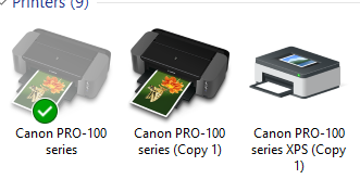

I do have the XPS printer installed, I just wasn't sure what benefit the XPS printer has over the regular printer.  Since you have been so helpful, I might as well ask, should I be using the XPS printer instead of the regular option?Capture.PNG

When I first got my printer I ran a little test using the Outbackphoto test image. Four prints - Lightroom, Print Studio Pro, LR+XPS version, PSP + XPS verison. I didn't really notice any difference at 13x19. I fianlized on using the XPS version printer and printing from Lightroom. XPS driver transfer data in 16-bit; maybe there are subtle transition differences in colors that aren't dramatically obvious, but since I don't have anydownside with using the XPS driver I use it - it can't hurt.
