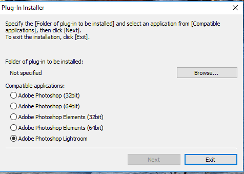

Hello everyone, thanks for letting me join the community!  I am an amateur photographer who recently bought the Pixma Pro 100 printer, and love it, but I have experienced a few issues with the color output.  When I print out a photo I have taken with colors in the green, red, orange and yellow spectrum, the picture seems to look very flat and overly yellow/orange (seem to lack the contrast that the screen shows).  Blues, blacks, and grays seem to be great, but I am looking for the best way to print exactly how I see it in Lightroom or Photoshop.  Maybe I haven't messed around with the settings enough to see how to perform this (change the sRGB settings, softproofing, or a way to simulate on screen how it will look when printed, not sure the technical term for that).  I was told that Print Studio Pro was a great way to print at the highest quality, but also told that the Lightroom print options are better than PSP, so im a bit confused on what to do.

Also, when I did try to install Print Studio Pro, it gave me an error saying "a verision of photoshop supported by PSP is not installed.  a sup[ported verision of Adobe Photoshop, Elements, or Lightroom is required to install the plug-in for PSP."  Not sure how to fix that either; does this come down to having the plugin and main printer files in the same folder?

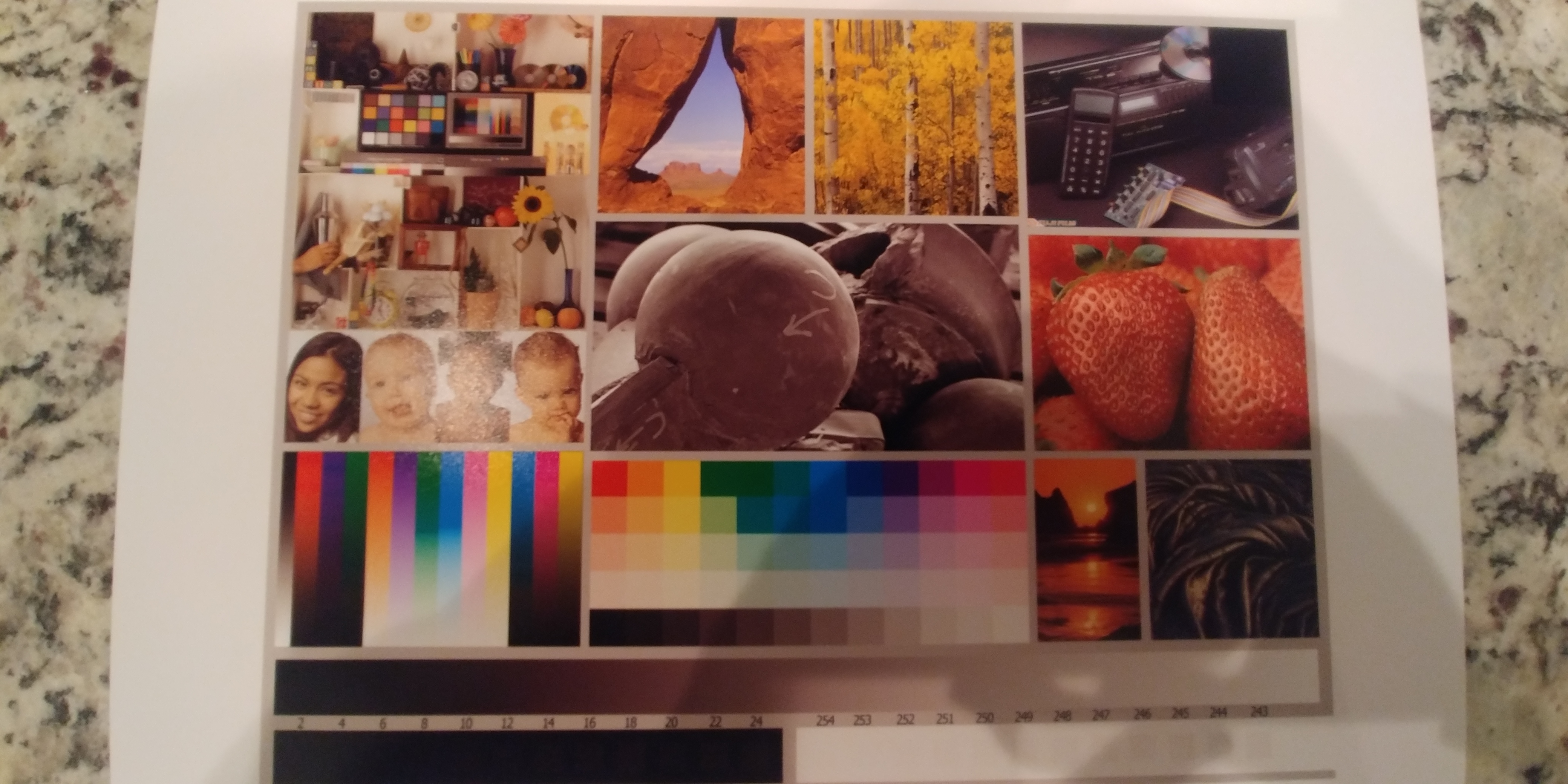

Ok, so I downloaded and printed the .TIFF, as well as read the article, and a few issues were identified; some of them confirmed my suspicions.  on the bottom left, the red is orange to me, the blue is purple, and the regular green is a hunter dark green, and so on so forth.  also, there is banding (?) on the middle green and blue strips.  for the RGB blocks, the blue and green in the middle top squares kinda blend together and arent really discernable between a few of them.  the asian girl is yellow, as well as the olive colored baby.  the red rocks are very faint orange instead of vibrant, the yellow trees are more of a flat yellow, and the strawberries are very faint almost orange and flat, not vibrant like the .TIFF file and my monitor.  the blending of black, gray, white looks good; all of the darker colors seem to do well, and there is no rings or banding with the sunset, so at least that seems to work ok.   But yes, when I print fall colors (red, orange, green) everything seems flat, and this seems to confirm my suspicions.  Do you have a suggestion on what can be done about this?undefined

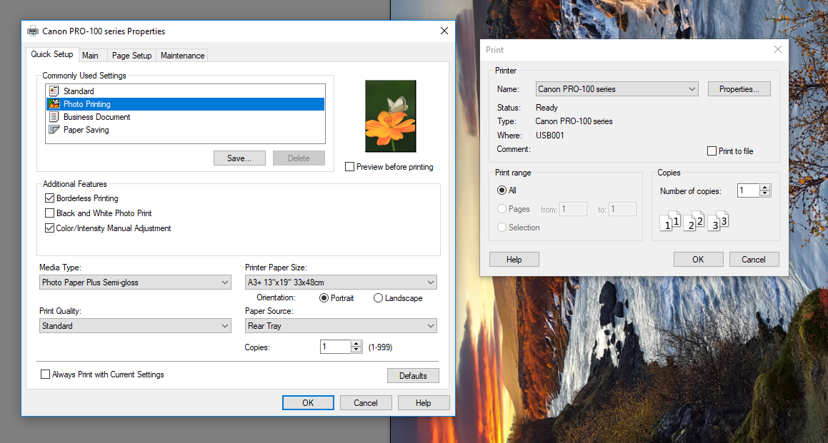

Let’s try with Lightroom. In the Print module at the bottom select Printer Manages Color abd on right side select Printer Settings and in the printer driver select the Canon paper you are using. Then print the test image.
Here are the settings (I chose A3+ and Photo Paper Pro Luster):

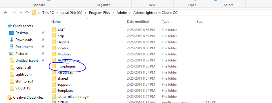

Ok so I got home and tried to make sure my plug-in was installed in the correct location.  I followed the link you posted a few responses ago, and the location does not seem to be the same as mine.  Here are my adobe paths (I have 1 in program files and another in program files 86):
undefined
So I do not actually see a photoshop folder, but the Lightroom Classic CC is there, so I click it, and is this where the PSP should be installed in?:

when using the PSP installer, and I get to the portion where I have to choose photoshop (or lightroom), the next button will be grayed out for all options, so I just want to make sure I browse to the correct folder, and maybe that is my problem with the plug in not being available for me?

and finally, here were/are my print settings.  All look to be close to the same as yours, but i have the borderless printing and color/intensity manual adjustment clicked, please let me know if those need to be removed.  I have wasted soooo much ink and paper testing this out to try and get it right, and I will continue to do so, however I thought I would just ask first.
undefined
I did not see an option in lightroom for "printer manages color."  I chose the paper settings I did because it is the exact paper I am actually using (Semi Gloss, A3).
