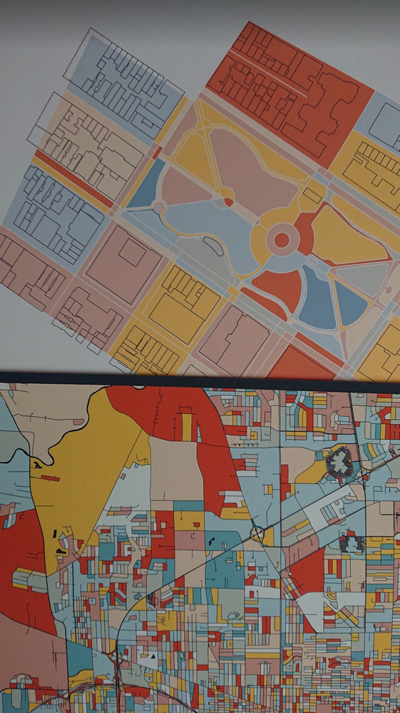

I've been using my Pro-100 regularly for years without issue (after the initial learning curve). My prints always come out beautifully and the colors have lived up to my expectations. Until about a month ago, when everything started looking unsaturated and crushed. I thought this might be to do with upgrading to OS 13 (since Apple broke parts of the printing system), or Photoshop 2023 not playing well with the printer. So I rolled back to PS 2020, then 2021, then 2022 and tested all of them--but that was no help. So I uninstalled all printer utilities/drivers, Adobe CS, all ICC profiles (I use Red River Paper/profiles), rest the printing system--I did a clean install of everything except the OS, and set it all up again in the way it always used to work. But no, the colors are still wrong in exactly the same way. So I pulled out an older laptop running OS 11 and PS 2022. This one has ALWAYS printed the colors correctly. So I printed from an old print job file already on the computer so as not to accidentally "contaminate" it with some errant setting from the computer running OS 13, but no--the colors are still wrong. I have tried absolutely everything at this point. When I hold my new print jobs up to an old print with the same colors as a reference, I can see very clearly how off it looks. I'm attaching a photo I took side by side. It's a cellphone picture, so it's not exactly right, but compare the oranges and yellows and I think you can see what I mean. Correct colors on the bottom, incorrect on top. By the way, I've burned through almost an entire ink set trying to figure this out.
Bottom: correct colors; Top: incorrect colors

Thank you--I should have mentioned I preformed a cleaning (but not a deep cleaning) using the IJ printer utility. Everything came out fine. Would you expect doing it this way to provide additional benefit? I can do it again if so.
And yes, only ever Canon ink (which I get from Staples, because Amazon is full of fakes).
I really wanted to blame the OS, but since the same thing happens with an old computer too...
