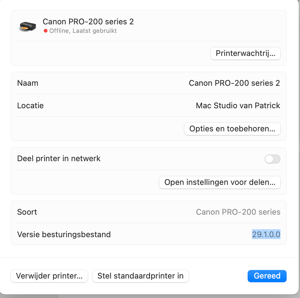

Problem:
When I choose matt paper on the printer and software (any software) the job goes to the print queue and stays there forever.
Nothing on the display of the printer. All other combinations works
What have I done:
Latest firmware on the printer.
Latest printer driver from canon
Computer (MacOS) up to date
Anyone has the same problem ?
I’m in Europe.

Hi PatrickMarq,
On your Mac, please click on the Apple in the upper left corner and then System Settings.
In System Settings, please scroll to the bottom of the left side and click on Printers & Scanners.
In the Printers window, click on your PRO-200 one time.
On the right side, what is listed to the right of "Kind" ?

Hi Patrick! Thank you for contributing to the Canon Community.
I see that you are unable to print on Matte Paper. The screenshot you provided shows that the correct driver (29.1.0.0) is being used by your Mac computer. You also mention that you can print on other paper combinations.

09-12-2025 12:53 PM
I have used the canon matte paper A4, the images had an size of 15x10 cm.
I’m leaving now for a photo trip of two week will try Canon print program afterwards.
