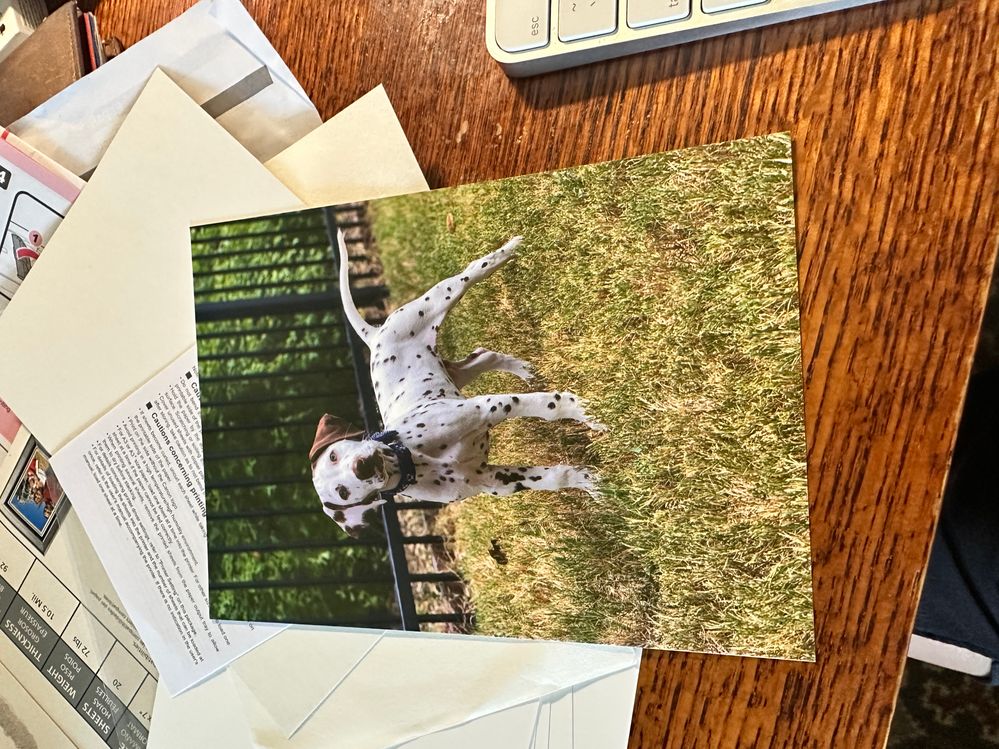

Well, I finally got the Pro-100 to print. I found out that the printer is almost 8 years old, bought on 10/10/17. Wow.
Hard to say what the final fix was, as I tried quite a few things, but worth mentioning:

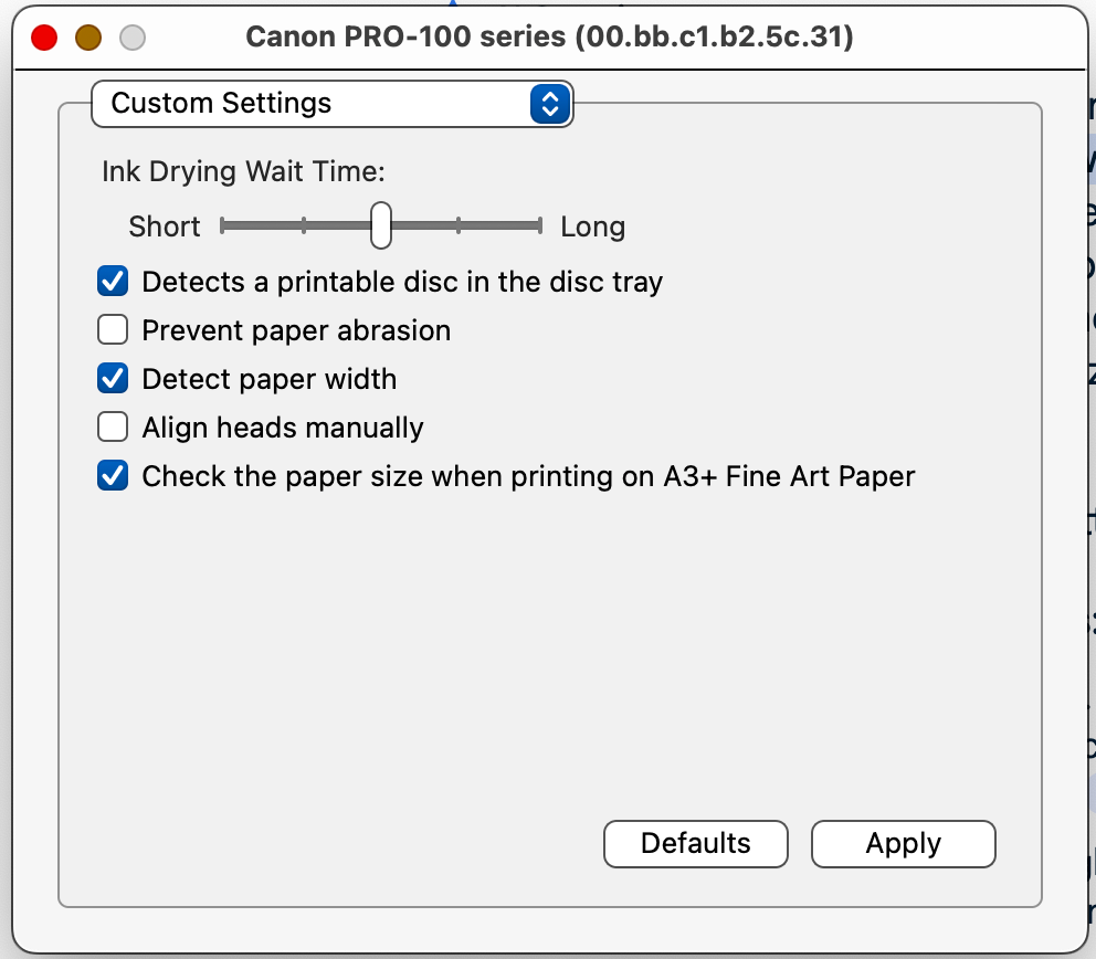

- I did check the Detect Paper Width box, in the Custom Settings area of the Printer Utility. As described by Canon, this isn't a physical piece of hardware doing the detection, but rather an option in the software. It was unchecked when I first found it, and checking it might have helped.
- I did clean the rollers, but got confused by the Rear and Manual naming convention, so had to do the Rear twice, the first time with three sheets of paper in the Manual loader, which didn't do what I thought it would, as might be expected, then again after I figured out what was what. I probably didn't need to do the Rear cleaning the second time, but by this time, I was checking all the boxes, crossing my fingers, and reciting the alphabet backwards...
I suspect those two things, along with all the updating of the drivers and understanding of the way this thing works, got me over the finish line. Thanks!Screenshot 2025-08-12 at 2.06.40 PM.png
