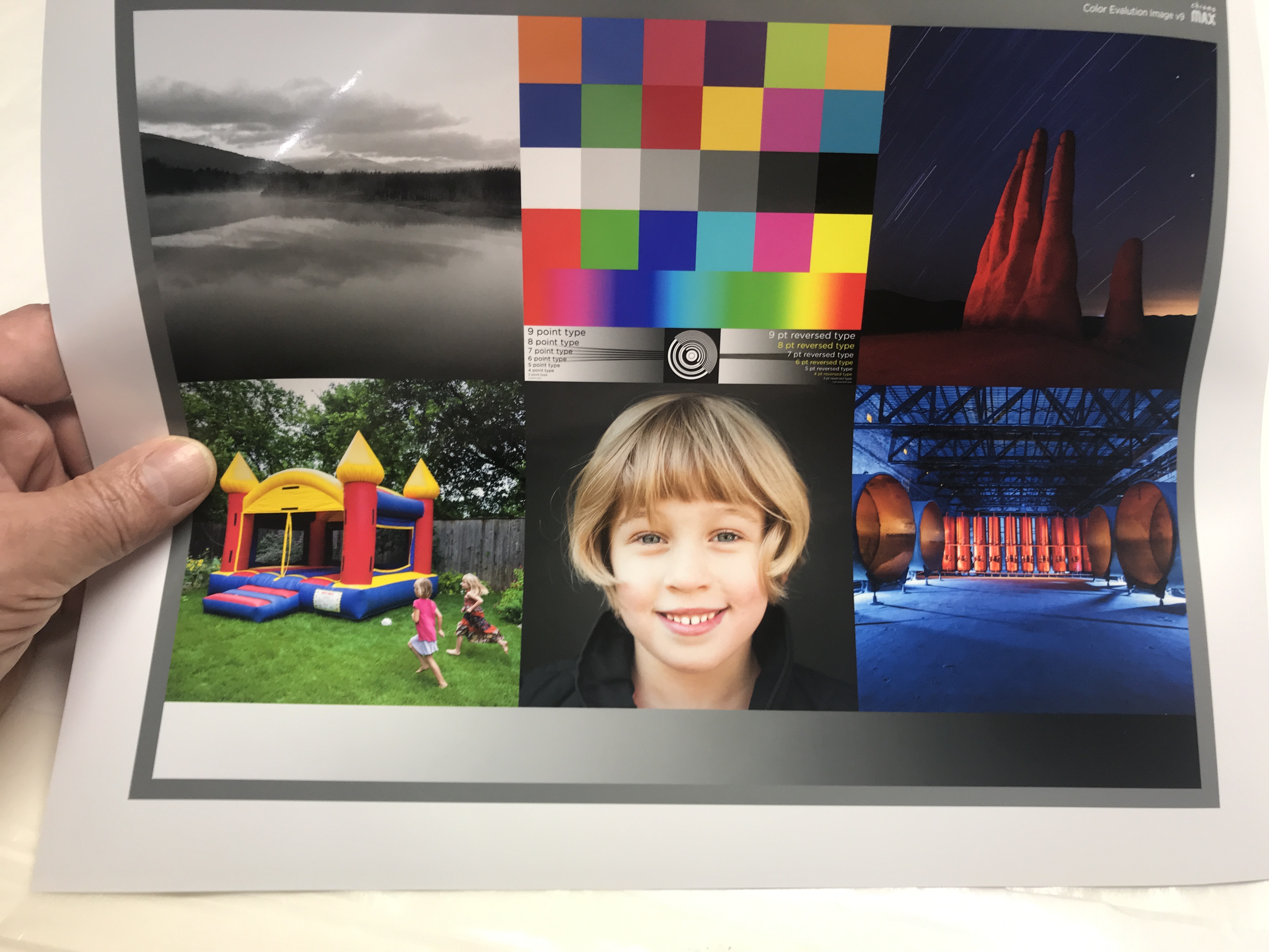

Now, I'm pretty sure this is the same Metalic Pearl as the Lexjet Metallic Pearl, and I happen to have some of that in-house, so I ran a test print using the Red River profile. Red River has an .am1x file for this too, but it forces you to use the manual feed in the back of the machine, so I used the Red River Metallic profile along with the media type Photo Glossy II.
I got fantastic results, and some of the brightest greens I've seen off of the Pro-1000 so far. Great color.
