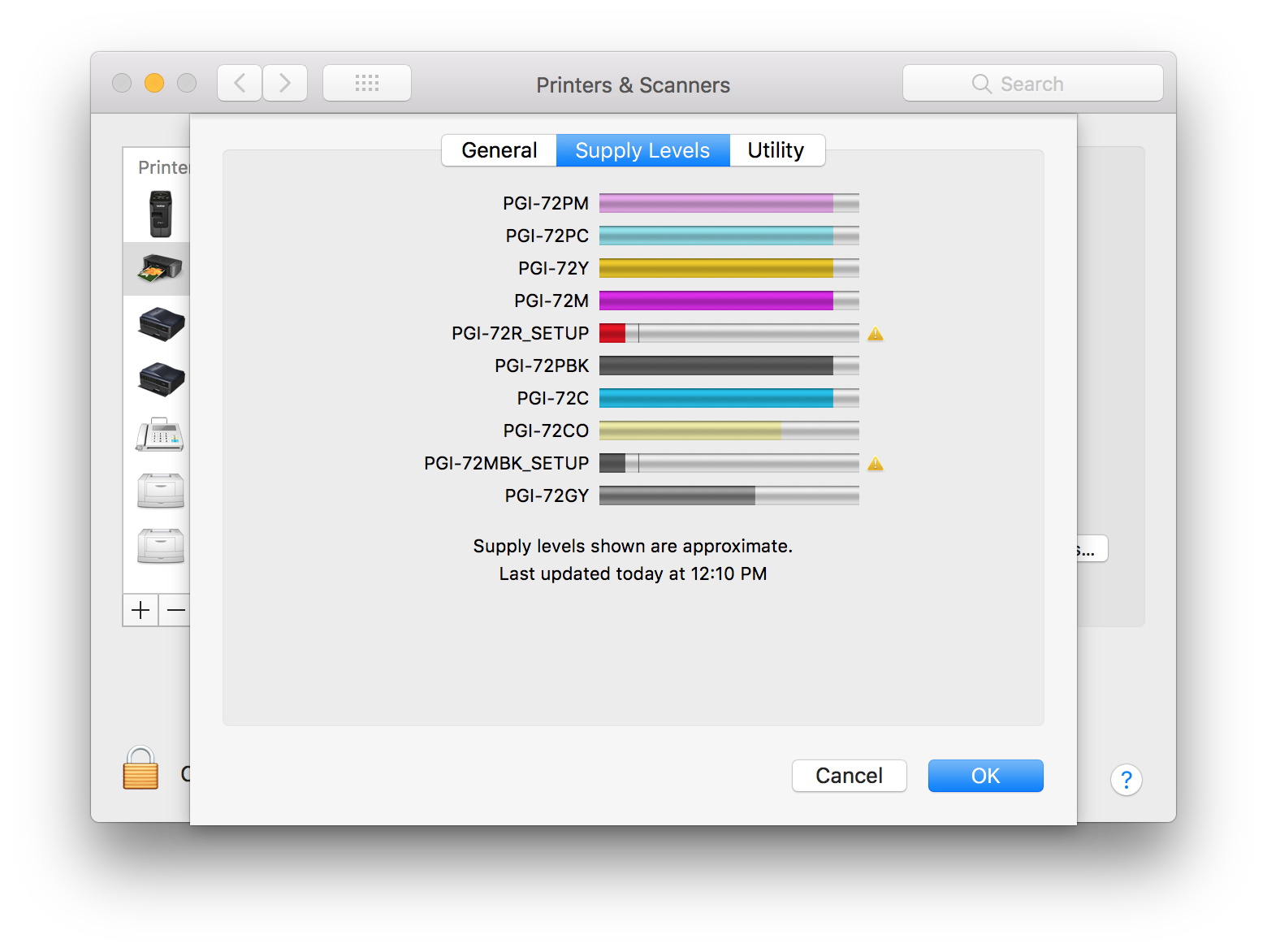

I'm using a PRO-10, not a PRO-100 ... but the concept of having to run a purge cycle when a tank is changed is the same.
Here's my current levels (I'm on a mac):
You can see that my red tank (PGI-72R_SETUP) and my matte-black (PGI-72MBK_SETUP) are both extremely low and have warning symbols displayed.  When either of these tanks hits empty, I'll swap BOTH tanks.
You can also see a thin black line on those graphs.  That line is the point where the printer will start giving you an ink-low warning.  Anything in that range should be swapped.  But frankly... if any ink were just a little more full than that mark... the purge cycle will probably push that ink below the mark and it'll start warning that the ink is low.
For this reason, I'd just swap anything close (I wouldn't necessarily swap EVERY ink ... you can see many are mostly full).
BTW, notice that the red and matte-black inks have a "_SETUP" suffix in the ink cartridge model.  That's because those are still original factory inks that came with the printer (on a "new" printer, all of them will have a "_SETUP" ink.)   Canon's starter ink (SETUP ink) is just a little more "full" than a normal cartridge.
This is because the print head is not on the tank... the tank feeds through a tube and into the print head (on the PRO-100 and PRO-10 the inks ride on top of the print head.)  The very first time the printer is powered on, it needs to prime the lines and this is going to use a bit of ink.  So Canon gives you a little extra so that after the print head is primed you still have a full-tank's worth of ink in the printer.
Once you run a tank empty, your placement tank wont have quite as much ink as the "SETUP" tanks ... but the printer doesn't need to fully prime them like it did the first time it was used.
