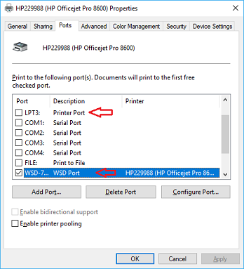

I'd uninstall the printer and start over. After uninstall, I'd remove the erroneous port you (or it) created during the intial install. How do you do that? After removing the device, set you default printer to something else. Now open the properties for another device and check the box next to the created interface, press delete port. Then ok. Now you are starting from a clean slate.
