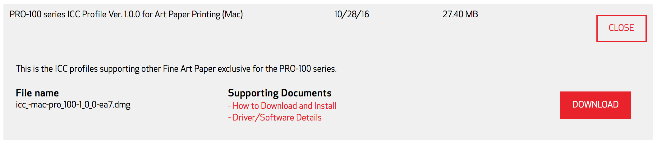

Your photo printing application likely has a color-profile section ... as does the default Mac print dialog box.
Your choices are to do nothing and let the printer handle the color (which probably would result in fairly decent, but not perfect, looking color.)
You also have the choice of having your print application manage the color profile selecction.
Lastly, you also have the choice of having the Mac's default print system manage the color profile selection.
It is very imporatant that whatever choice you pick... you only pick ONE place to do manage the color (if you told your print app to manage color, and also told the mac's print dialog to manage the color, then you'd end up doubly-applying the color profile correction... which would result in bad color (it would be like a person who needs glasses to correct their vision... wearing two pairs of glasses at the same time...  the second pair take the correction too far and you end up with a bad result.)
Lastly, there's the question of how you select the print profile.  Different types of paper absorb the inks differently... you have to select the correct type of paper for the print.  Basically a "profile" is a combination of the printer + ink type + paper combination.  Since this is a "new" Canon printer, you're probably printing using Canon's factory ink (just be aware that most downloadable profiles you can get either from Canon or from 3rd party paper vendors are typically assuming the use of Canon ink and likely wont be valid if you try 3rd party ink or refill your inks.)
Canon has downloadable print profiles for their own papers as well as downloadable profiles for several popular 3rd party papers (that even though it's not Canon paper, they were nice enough to make them.)
Go to this URL to download Canon's 3rd party profiles:
https://www.usa.canon.com/internet/portal/us/home/support/details/professional-large-format-printers...
You are looking for this:
If you don't see this choice on the software download list, change your OS type (at the top of the list) to macOS Sierra v10.12 (instead of High Sierra).  The ICC profiles are not os-specific but Canon hasn't updated their list to reflect this download for 10.13.
Also, make sure you've installed Canon Print Studio Pro (even if you never plan to use it) as I recall that's how I got the ICC proiles for all of the Canon papers.
The profiles themselves are installed to the operating system... not to any specific application.  This means that once you install them, any application can use them.
