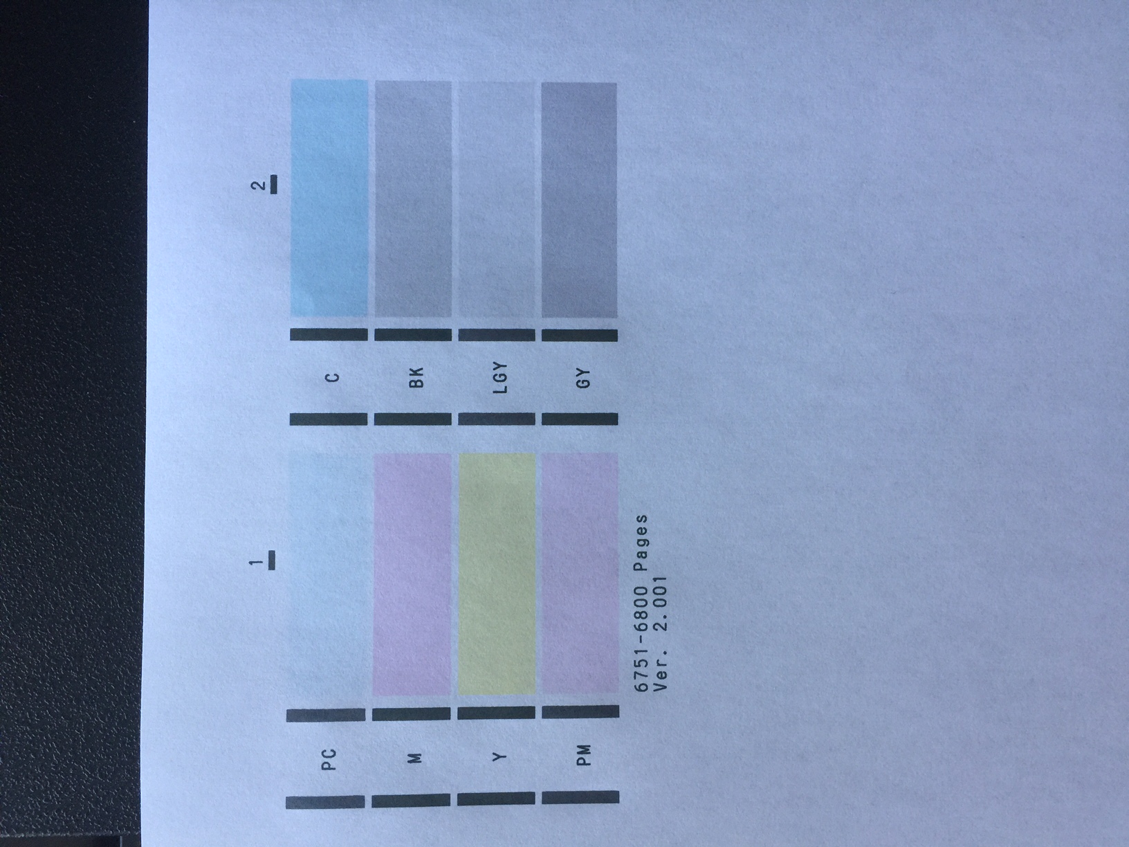

Run a nozzle check again and post a scan or smart phone photo.
Can you post a scan or photo of a print using this test image?
http://www.outbackphoto.com/printinginsights/pi049/essay.html
Did you run a roller clean and plate clean as well as a nozzle cleaning?
Verify that all your cartridges are seated and there are no flashing cartridges.

Hello,
Thank you for the response. Here is the image you requested me to print along with the nozzle check test print and the 3rd image is my colour chart (the one on the left is how my printer used to print the colour and the one on the right is what it is doing now, it looks like the colours have brown/grey added to them).
All my inks have been changed and are full. I did a roller clean and a plate clean too. Still printing muddy. Im not sure if the ICC settings matter as I am printing on cardstock not photo paper. As of now I have it set to plain paper.
Lesley

The ICC profile will matter. Do you you have any photo paper? Printing on that will confirm that your printer is OK.
Try selecting Canon Museum Etching profile. It has a surface that looks similar to your card stock.
What at color is the raw card stock? If it's off white that's going to influence print colors.
Does the cardstock supplier provide ICC profiles or recommendations.
You can can also use the printer driver to print a test pattern that will provide printer adjustments.
