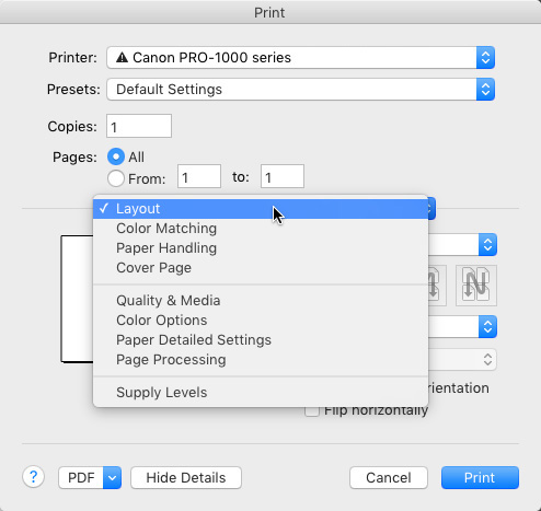

03-06-2018 12:37 PM
What menu options do you now have? I don't see how to turn off color management using PRO-1000 on a Mac?
03-06-2018 01:17 PM
03-06-2018 01:50 PM
Thanks, John. I keep reading and found where you helped someone else with this, as well. 🙂
