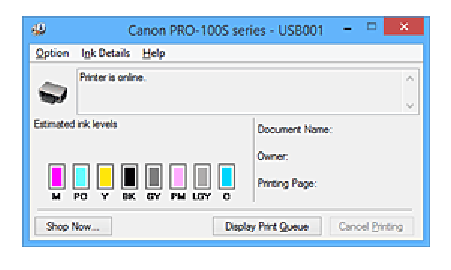

I am not sure how I find the IJ status monitor. This is something new for me. Perhaps you can indicate where this is found. Thanks.

Check the IJ link in my post above
https://ugp01.c-ij.com/ij/webmanual/PrinterDriver/W/PRO-100S%20series/1.0/EN/PPG/dg-c_ink.html
