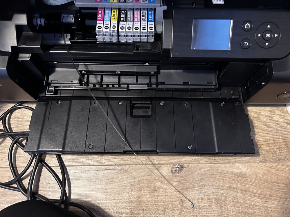

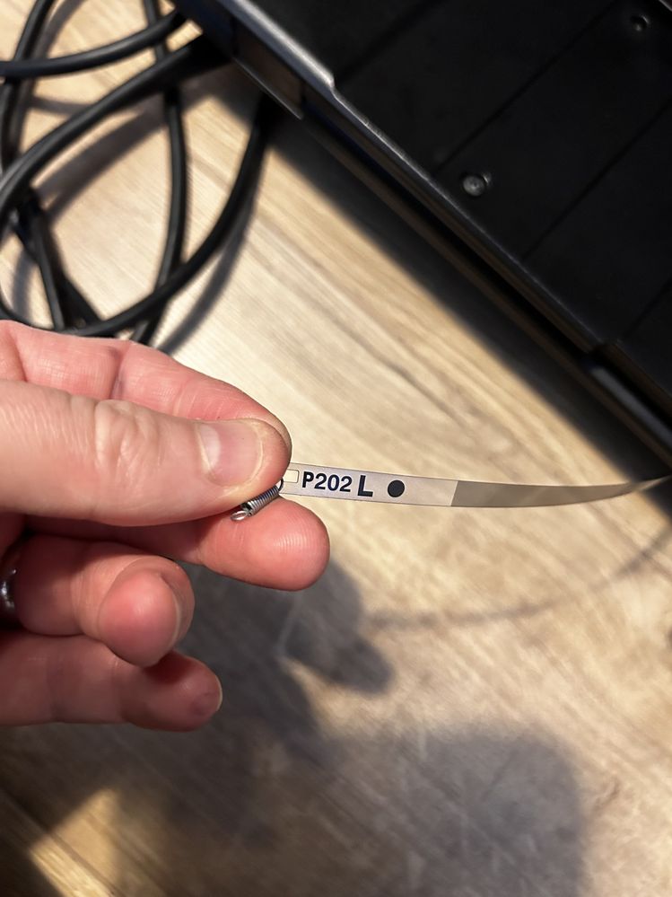

I don't suppose anywhere here can urgently help! One of the ribbons inside my Canon Pixma Pro 200 has come loose and is causing the printer to throw up an error that a foreign object is inside the printer. I'll attach photos, does anyone know where this ribbon reconnects? One end appears to be attached the back of where the cartridges sit and has the code P202 L on it?

The part in question is the encoder (timing) strip. It's possible it could be refastened where it came loose from inside the printer. If that's broken, The cost to replace might exceed the value of the device once it's shipped to a repair facility.
