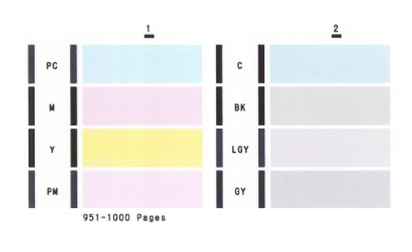

First, please make sure that all of the ink tanks inserted in your PIXMA PRO-100 are genuine Canon ink tanks.
Once you have confirmed that all of the ink tanks are genuine Canon ink tanks, please print a test page. Please load plain paper in your PIXMA PRO-100 and then press and hold the RESUME button until the printer light blinks white twice, then let go of the button.
Please compare your printout with this example:

Thanks for the replys. I discovered that my black cartridge was clogged and I guess the printer was trying to compensate by using the cyan ink. I changed out the black cartridge and everything is fine now. I am surprised that when I contacted Canon that they didn't even suggest that as a possibility. Oh well, alls well that ends well.
