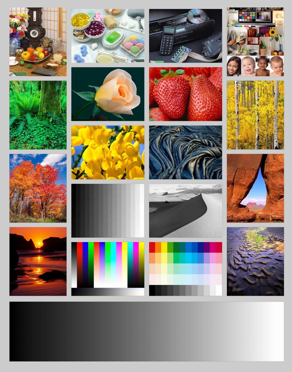

1. Have you run a nozzle check?
2. Print this test image and post results. Do not make any adjustments to the image before you print it.
http://www.outbackphoto.com/printinginsights/pi049/essay.html

Yes sir, that's the first thing I tried. All seems to be in order there. Since posting this, I've downloaded and printed a couple of color test patterns. Blues all look purple there as well, and I know that's not a monitor issue
. I will continue to tweak color management I suppose. I'll stumble across an acceptable combination at some point. Le sigh...

Yes, the paper is much whiter than the picture. So I guess it's not a perfect representation of what I'm seeing, but it does show how different the two are. Further research (and the example posted right above, which looks exactly what I'm getting) have me thinking it might be double color management, but I'm not sure how that happens or how to make it unhappen. I'm using the Digital Photo Professional 4 software, which I'm assuming I downloaded from the Canon website. I've also tried just printing from GIMP and also using the default Canon printer driver.
Another question: if I'm trying to print a test page like this one, does it matter if my monitor is perfectly calibrated? I know the strawberries should be bright red and the sky should be blue, but they're just off. It seems like if I print it straight through the printer driver it should look correct regardless of my monitor, but I'm obviously just throwing darts here (with my off hand to boot)

I just read your post again. I now see that what you posted is a test image, not your output.
Let me get to my PC and I will post the settings you should use in DPP.
Clear any print settings yiou made in DPP and then set the driver as shown when you select Print:
Since you are ujsing DPP you may want to download and install canon print Studio pro and print through it. It will interface with DPP.
I also suggest you reset your monitor to factory default and disable the blue screen feature if there is an option to do that.
